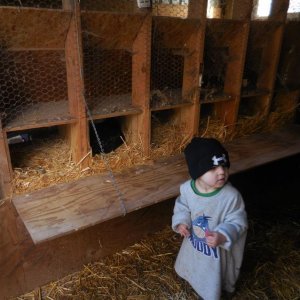

You might also want to think about a window or at least some wall vents of some kind to keep some air moving through there as that tin does get a little hot.
larry_g
Apr 28, 2007
16,931
oregon
1641598210241.pngTwo thing I see here that I don't like and changed in our coop. Put an angled roof on the nesting boxes so the chickens will not roost up their and cover it with ****. Second is you have to wade through the coop to get the eggs. In ours I have a door on the back of the nesting boxes so that we can gather eggs from the 'clean' side of the building. I also agree with the venting to keep things cool when necessary. Also give some thought to cleaning the roost area. We only have a 30" door for access and it is a pain to haul out the waste. Consider a larger door in the roost to directly outside so that you can pitch the waste out and directly into whatever you haul it away in.
You can see the door on the chicken boxes and somewhat the angled roof on top in the above picture. This is from the 'clean' side. We figure 3 chickens per nesting box, they share.
Boostingaz
May 21, 2018
3,723
Indiana
Valid point on the angled roof to the top box. I may eventually change to that! We have lots of chickens that like to be up high. There is a whole little group of them that perch and sleep up in the rafters.
The eggs aren't that bad to collect. Just walk in and pick them out. That picture is taken from the door so you can't see it but there is a 36" x 6 ft door there that opens for cleanup.
There is a both a front and back door on the shed. The front door goes in the clean storage side, then there is a man door that separates the two sides and leads into the coop side and then a back door that goes out of the coop side for cleanup. The back door stays closed when not cleaning to keep the larger animals out of the coop. All of our animals free range during the day and have access to that door but can't actually get into the coop.
I can easily fit a wheelbarrow in the coop for clean up.
I know this may not be everyone's ideal set up, but this has worked well for us for years. We have to have the ability to easily lock everyone up as we have lots of predators around. We have separate night time pens for the goats, etc. Fence panels and tin make for super easy reconfigurable pens. I have tons of these panels that we can add, take away and make all shapes and sizes of pens as needed.
