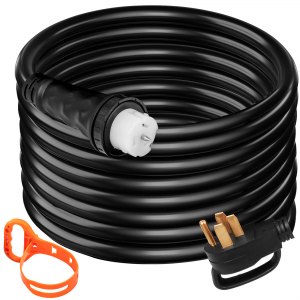

I found 8/4 in a 100 foot length for $150
Says 600V SEOOW Water Resistant
Not sure if this is even an option to consider
Assuming you get cord how are you going to run this, just on the ground?

Yes it would be plugged into the back of the travel trailer/camper and run under the frame via loop hooks.
Then at the front of the camper it would have to go to the ground and lay on the ground about 7 feet to the outlet pedestal

Why are you not using the "standard" RV cable which is 6 gauge? 8/4 will "work" but it's not rated for the typical 50A breaker on an RV pedestal. If I was going to do that, I'd de-rate the breaker.
Again, I'm not sure a standard 50 foot premade cord/cable will work and be long enough . It's a possible option for $200 on Amazon
The 100 foot premade cable will definitely be too long and they are like $400

Got it, I was confused by the post above where you said it was going to go about 7 feet to the pedestal.
You can use that cord - but you really need to de-rate your breaker... I'm speaking in "practical" terms, not giving code advice.

I'd rather error on the side of caution and use 50amp with 6/3
That's what's currently installed and there's been zero issues

the NM-b is not kosher and you will have issues eventually. use the right stuff or dont do it at all

The old 6/3 cable pulled out of the ground pretty easy from inside the buried conduit, barely used any wire lubricant.......it was probably 70 feet long total
Posted it in the campground ads and sold it same day for $80
Bought a used 50amp 50' rv cord for $120 and all is well
