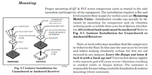

I have the same compressor, and the instructions specifically say, no insulators, just bolt it to the concrete with expansion bolts. Not an issue, because you really don't feel any vibration while it's running. My compressor has it's own circuit, the welders and the mill share a circuit, and the hoist has it's own circuit, safer that way.
That's what I thought too but then I found this in the manual:

all vertical tanks must be mounted, who came up with that? out of fifty years, I have never mounted mine and never saw one that was. I alway slide mine away from the wall, to sweep behind it, dust get evereywhere

I'm trying to figure out why Quincy would say not to use isolators. Not picking on you Lotek as I've seen this mentioned a couple times elsewhere.
Why would you not want to dampen the vibration from a reciprocating pump? I imagine it cuts down on noise and gives the legs of the tank a little shock absorption.
