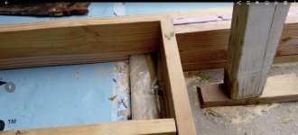

255
Forms removed from the wall. I scored a good deal on some used 3" and 4" Owens formula 250. I installed the 4" along back north and east wall. I installed the 3" on the inside. On both the inside and outside the insulation is sitting on the footing. I did include a picture of how I install electrical conduits when you use a Rapid style form. I use a 3/4" rigid 90 and then stub up with PVC to above the finish concrete height. Duct tape each end and secure the conduit inside the forms with wire to the form ties.
  • interior wall insulation going on. Red circles indicate where to hole saw a clean hole for futur.jpg
  • Forms removed, water proofing done and 3 inch insullation goin on the foundation.jpg
  • how to install electric conduit in a concrete pour. Red circles show both ends..jpg

The new family room is being built over an existing concrete porch. Laid down 10mil poly followed by 1/2" Dow Tuff-R insulation over the whole area. 2x8 PT lumber was used for the floor framing. This was followed by 5" of foam insulation cut to fit between the floor joist. I then installed 1/2" pipe between the floor joist.
  • poly laid down then  half inch Dow Tuff insulation. All seames were sealed..jpg
