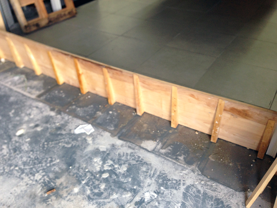

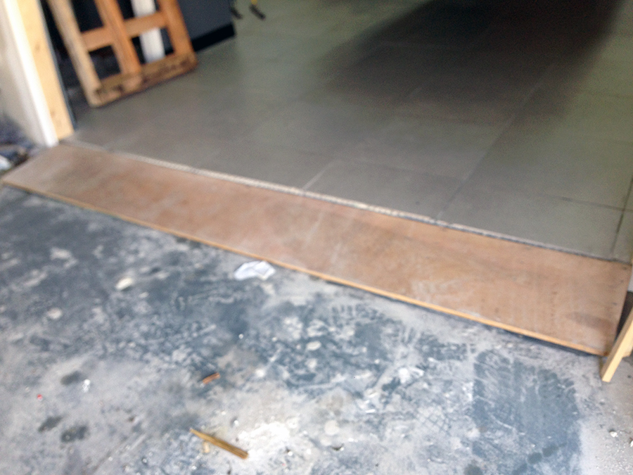

Madhatter: no hurry because with holidays and a new member added to your family you are a busy guy not mentioning all the cool car stuff you are doing. i didn't know if you have had a chance to show how you make the 2 or 3 inch transition into your basement's portion of the garage.
did you say you made it out of wood and is it fairly permanent or do you just have it available to put down when you need it.
Happy Thanksgiving and everything is looking awesome.
Without further delay...
Not the best picture but it gives you an idea of what the ramp looks like. I plan on coating it in rhino liner sooner.

Madhatter: thank you very much and very solid design. is it about 18 inches front to back and is your rise 3 inches? if you are pushing your cars or toolboxes up in and out of the room you might also find a piece of siding or molding that takes the lip down from the 3/4 or inch to nothing for a smooth transition. i tend to move heavy stuff into my storage unit and i have about a 3inch lip like yours and with a lot of weight on casters or a pallet jack any bump tends to cause a bruise or movement on the pallet.
cheers and best of luck finishing it up. also have fun with those fancy cars you own, but not too much fun.

Once the 4 car garage gets tiled...which will be very soon then there wont be any gap at all. It was made when both surfaces weren't tiled...and now one is. I have some smaller transistion pieces in storage right now too. When this never ending project is over I get it more presentable and add some additional pics :)

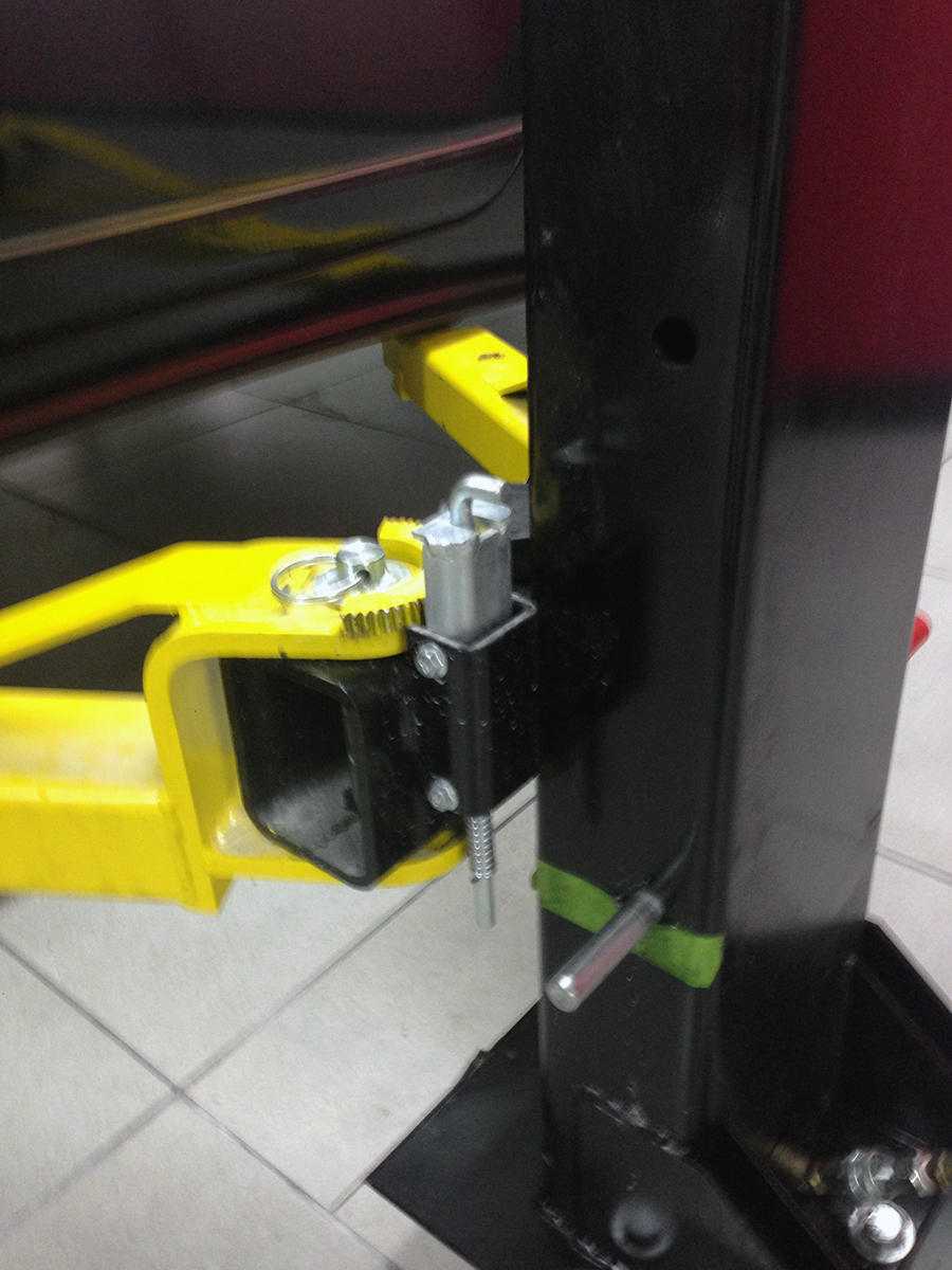

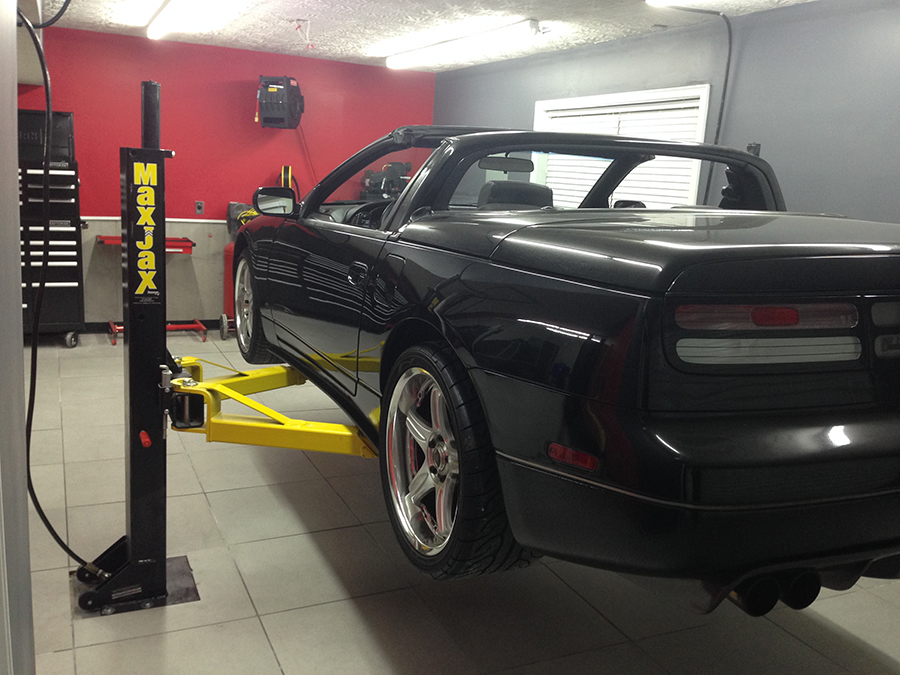

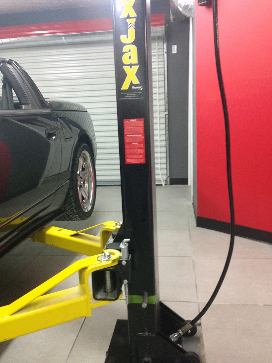

Made a modifcation to the Maxjax this weekend. The two height settings from the factory are great but I felt like it needed a lower setting as well for doing work in the engine bay as well as using a creeper underneath the car. I set these new holes around 12.5. It took FOREVER to drill through the posts....which is a good thing I guess :)

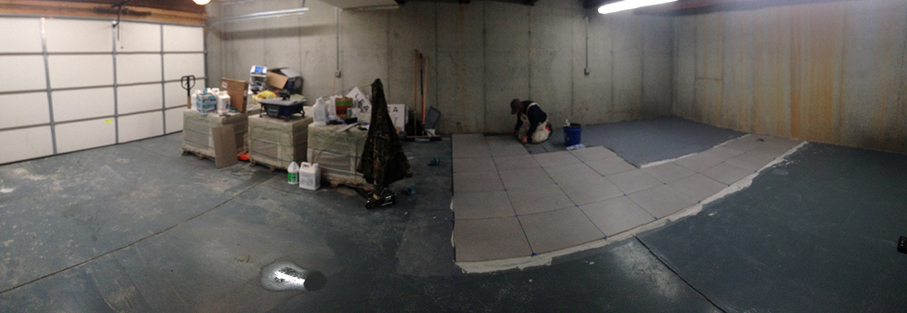

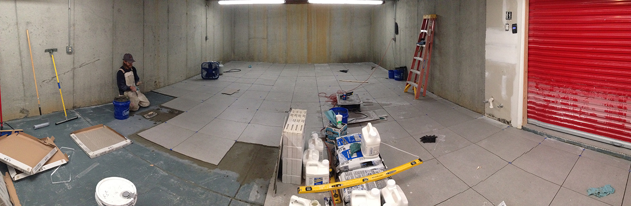

Finally got started on the 2nd stage of tile
