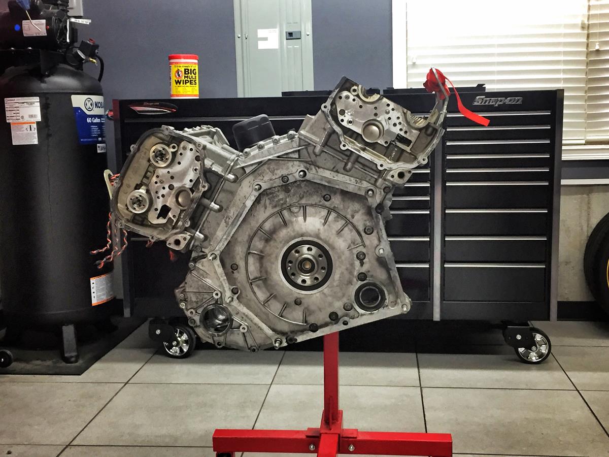

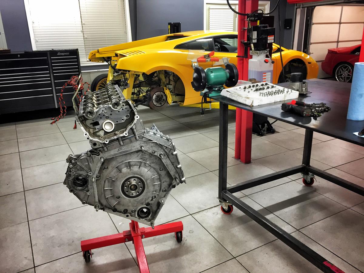

Finally got the engine on a stand and will hopefully have time to start tearing it down later this week

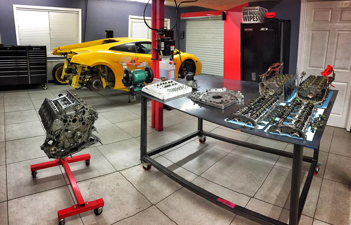

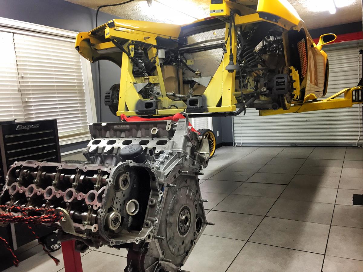

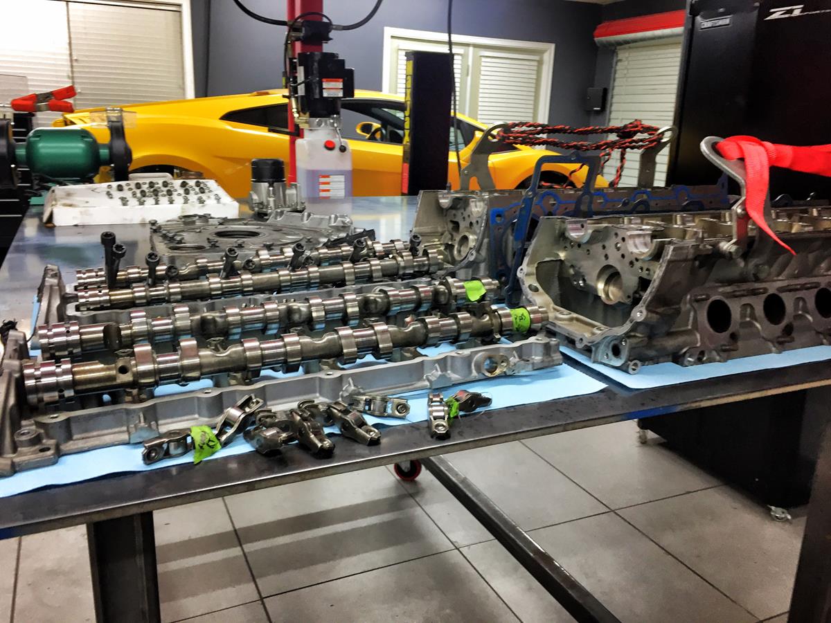

I got some time this evening and decided to start on breaking the rest of the engine down.....very pleased with how everything went.
Got one head off....engine looks goofy like this
Both heads off
Timing cover off
Everything organized in its proper place
and....the girlfriends golden taking a nap upstairs

Lambo project looks very interesting Saxon.
Looking forward to seeing how it turns out.
You know if you added a shelf to the bottom of that metal table of yours it would give you more parts lay down area without having to walk around them on the floor.
But since I see nothing on your floor, maybe you don't need a shelf.
100% a bottom shelf happens. I already have most of the material to do it but just haven't made time :)

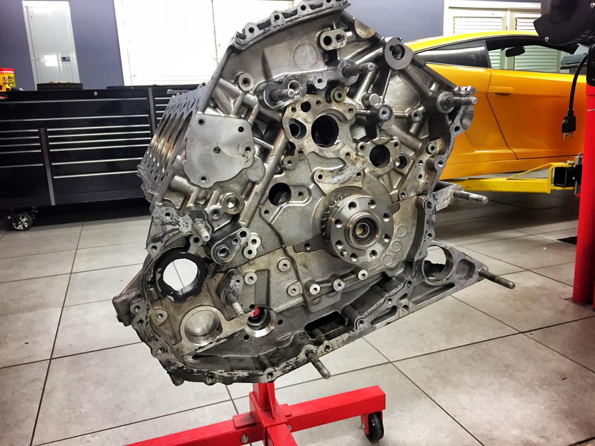

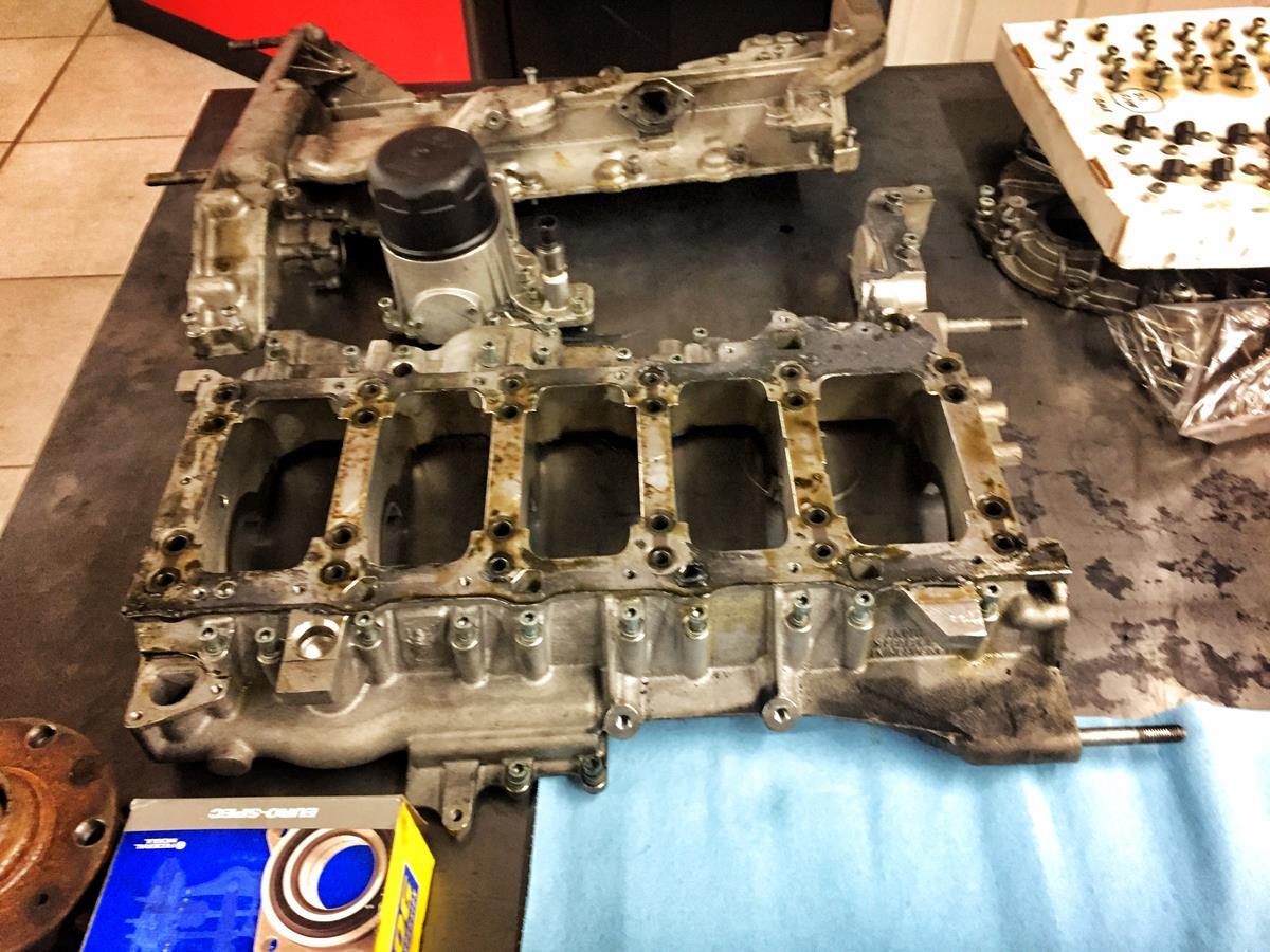

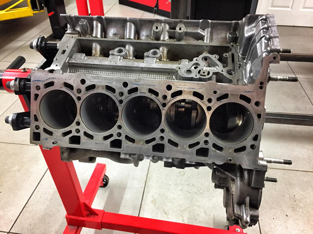

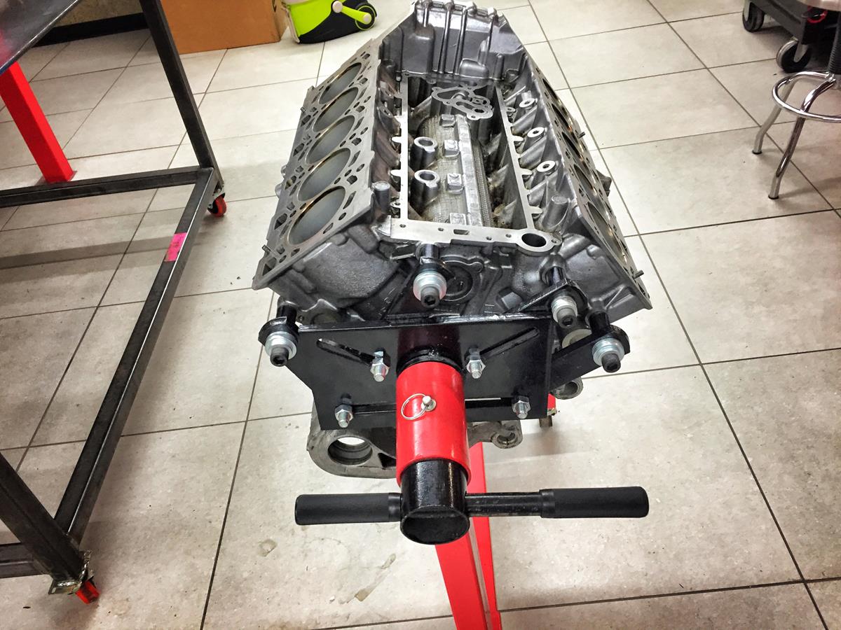

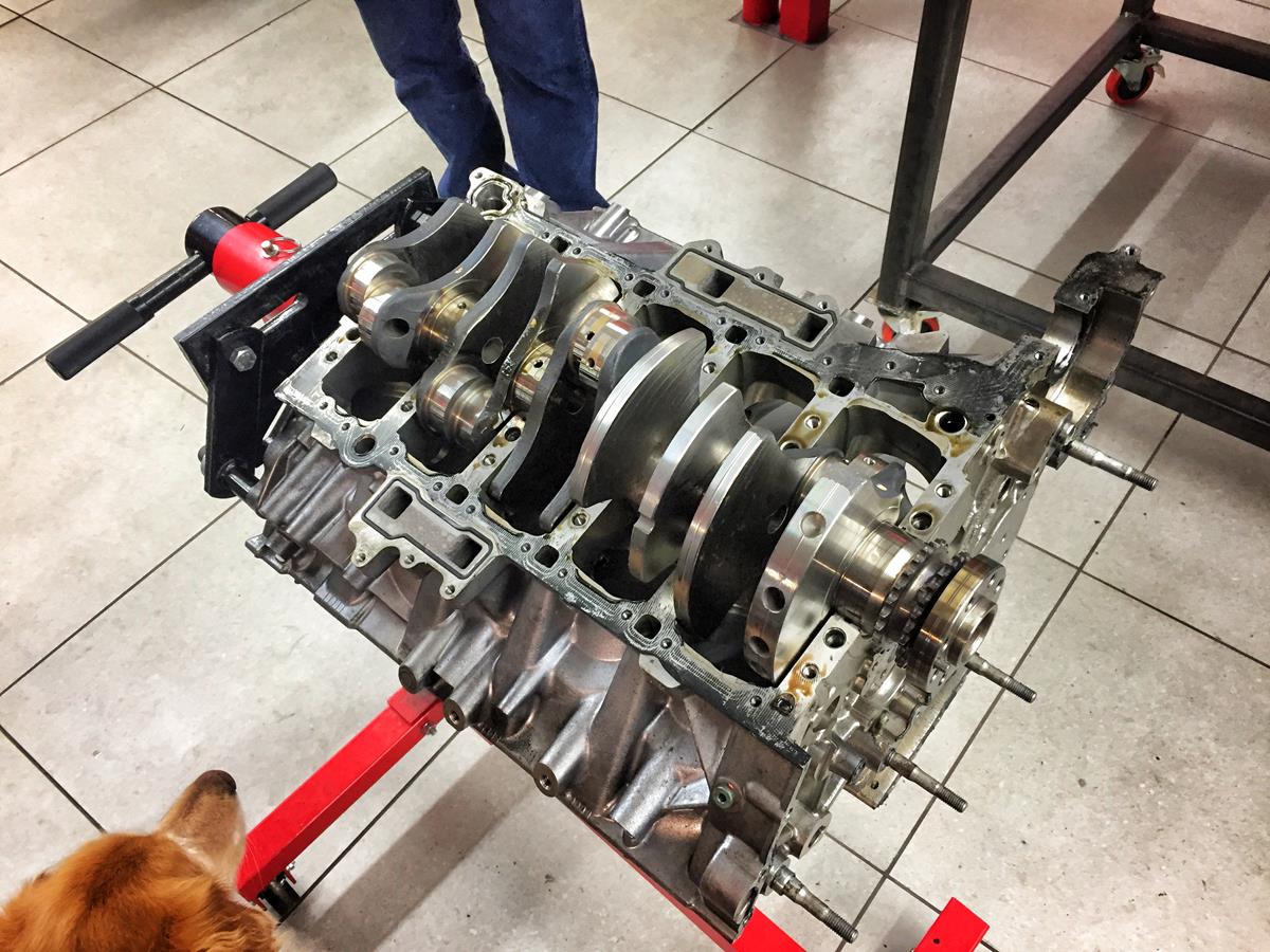

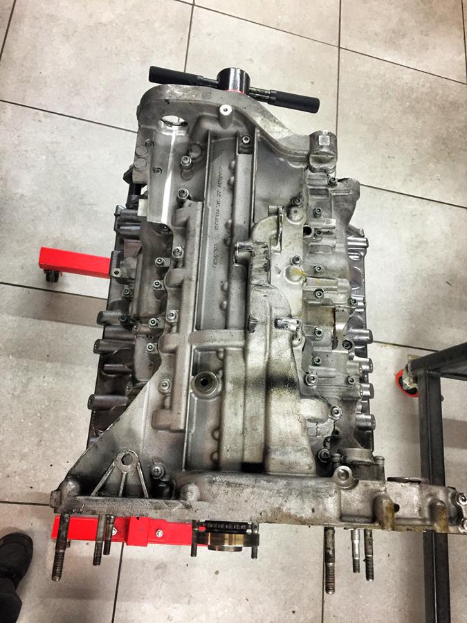

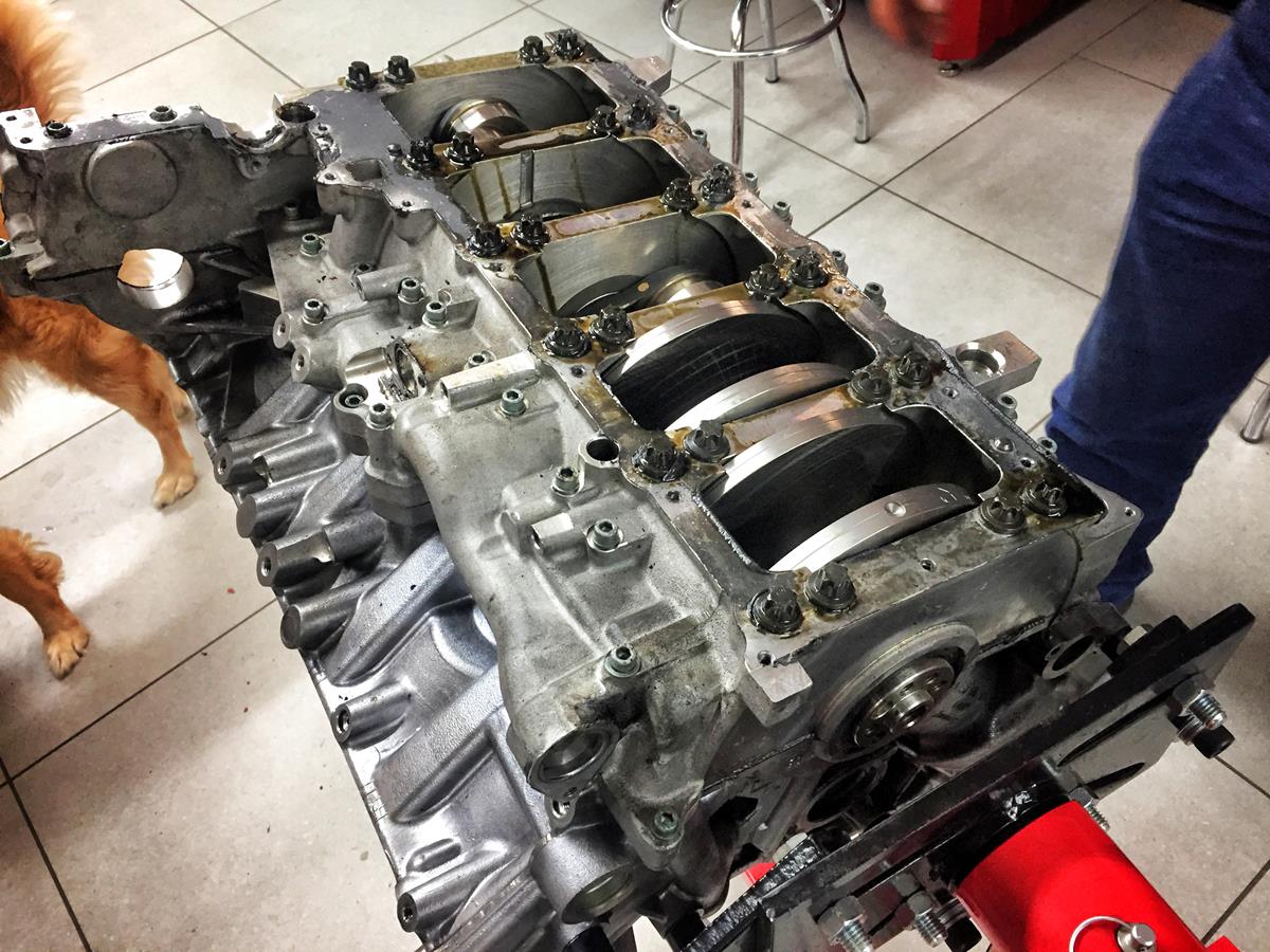

I made some solid progress today on the block and have it 100% stripped now.
Next step will be making some final decisions on if I will get it sleeved or try to have it rehoned.
The major Lambo builders in the US have contracts in place with some of the best machine shops and they wont do work for you unless you are with a big name shop. What a racket.
This irritates me quite a bit. So I am going to document this entire build, the parts that I use, all of my engine specs, wiring and my a copy of my engines map and then give it away online.
on to pics....
All stripped down
Crank out
upper and lower engine pans

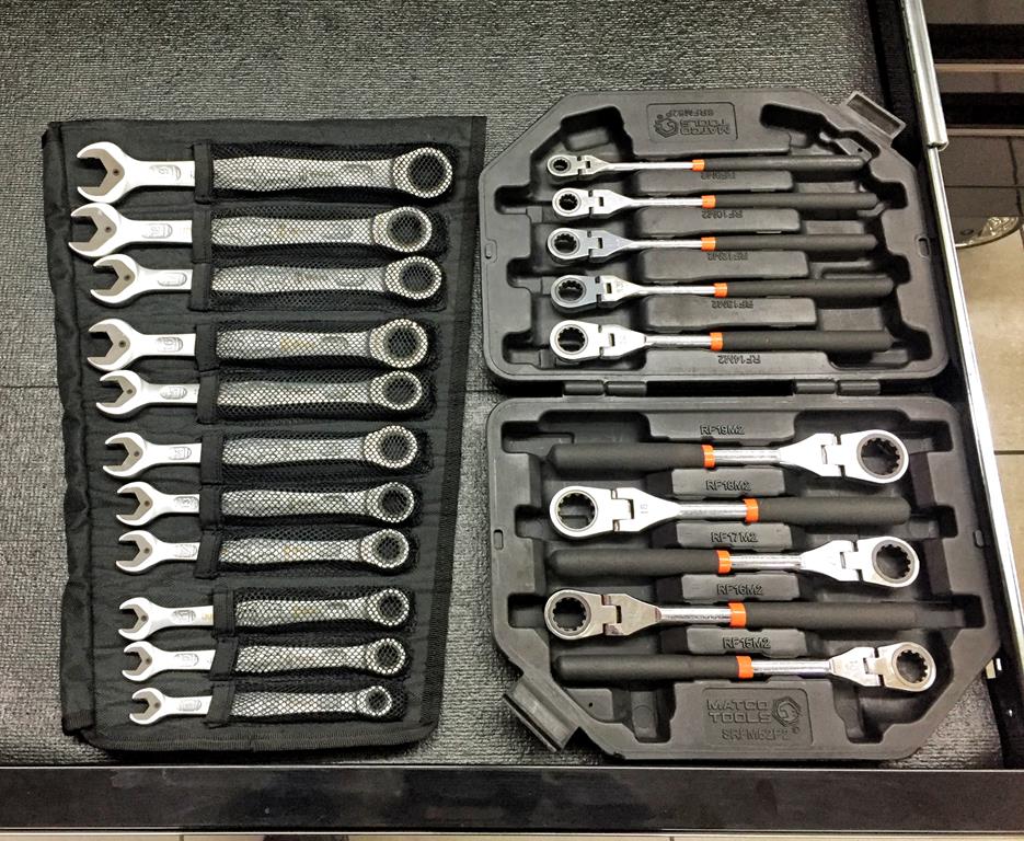

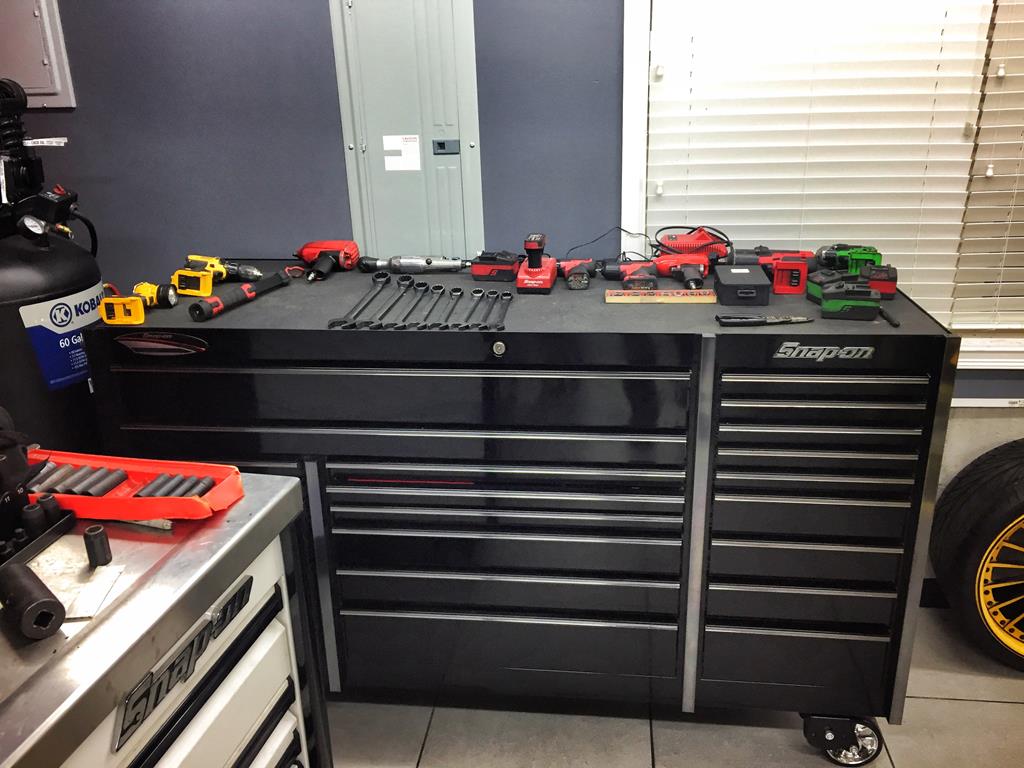

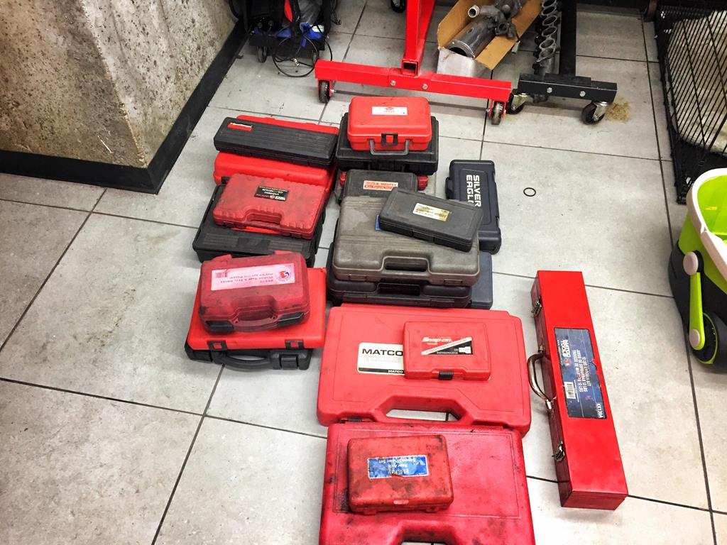

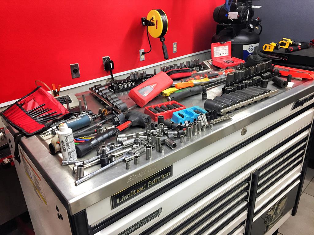

I had been wanting a set of Wera Joker wrenches and found a good deal locally.
And I ended up finding a guy that was retiring from being a mechanic and sold me everything that he had. Two 90th Anniversary Snap on boxes just loaded with tools. So I have started going through them and deciding what to keep and what to sell.
David Walter
Sep 30, 2013
114
Gundaroo, Australia
Kudos to you. I was dragged into this racket previously, after I did something similar but with engine mapping. The major players pressure you to "join the cartel". I wish I never did, and shared my findings as I went. I have since published all of my findings on line, as I remember how much of a chore it was to just get started learning, and who to talk to who have been just fantastic starting point. However, the comment were normally "bring it into our shop and we will do it...".
Lover the build plans. As for the snap-on tools from your mechanic. I am not sure there would be any that I would or could let go. You yanks have the best access to quality tools at prices that are not comparable to a house purchase in price.

Are yo keeping the boxes as well or selling? Or will u just sell ur other boxes and keep the snappy's?

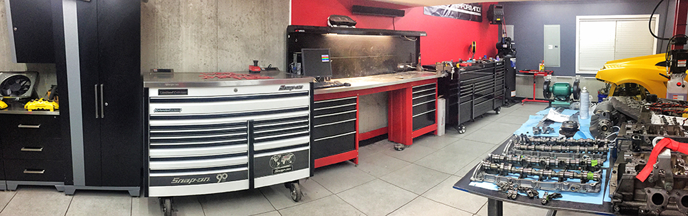

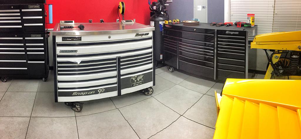

Lexington, KY
I am playing around with the idea of keeping all of the white boxes too....mock up I did over the weekend. I will prob sell....but still thinking on it.
