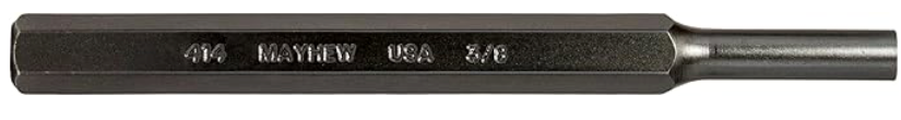

I need to center punch a broken bolt that is recessed about 7 inches.
Is there a center punch that length?
Or is there an extension that I can add to the center punch to reach 8 inches in?
If not, I guess I'm going to cobble together a flat punch to the back of a center punch somehow with monster tape or a hose clamp or something.
Thanks!

I looked at a few places online and didn't see one that long.
Maybe along piece of SS rod and grind a point ?
I don't know, sounds like work that I would not be able to get right, and not sure that steel is going to be hard enough.
Maybe I'll put something like this on the back end and hose clamp it together, unless there is a better way to combine them:

Have a welder ?
It's not going to be a high use tool. Maybe find a cheap center punch and weld a section of Key stock to it.

This is a longshot, but Klein makes a scratch awl where the shaft runs through the handle. The plastic handle could be cut off leaving a 10" long ice pick. I use mine (with the handle still attached) as a center punch all the time.

If its just for a one off, you can use pretty much anything metal. Old broken screwdriver, threaded rod, a piece of old rebar. I often reach for a lengthy bolt.
Hold it against a linisher and twist it around.
Cut the head of the bolt off, hold it in a drill and spin it against a flap disc on a grinder. Might need to touch it up after one or two punches.
A deep socket that the back of the centre punch fits in.
Get creative, dont get fancy.
Unless you’re doing it a lot. Then get fancy creative.

Use a regular transfer punch and if it's not long enough, hit it with a second punch end to end. Might need a magnet retriever to pull the transfer punch out of the hole.

Can we assume you need the punch to put its indent dead center in the broken bolt? A transfer punch will allow you to do that within 1/128 of an inch but what are you going to do with the bolt once you have marked the center?? The problem with using some random size piece of steel is hitting center but getting that transfer punch out will be quite a challenge. I would use drill rod to be able to get the diameter and length you need ground of course to a concentric point.

Oh, I like the deep socket idea...impact socket and extension. That could work. Stuff some rubber around the punch before inserting it into the socket to center it. Sounds really good!
Everything else I've heard is good ideas, thank you, but this is probably one and done and I don't have these fabrication tools and skills other guys are talking about. Just the basic stuff here like files and angle grinder, I do have a bench grinder in a box somewhere but have not installed it at this house yet...need to do that.

They make sized transfer punches that will automatically center in the hole. Even if they are not quite long enough you can tap the end of the transfer punch with another punch and retrieve it with a magnet.
However better yet, since you have a long hole, would be to turn or have a friend turn a tight fitting sleeve and drill the sleeve for the size of extended drill bit you will be using. Then you don't have to worry about drilling off center or having the drill bit wonder.

It's not a hole, it's a mounting bracket under a car with such a tight spot I can't get tools within 7". I will take a video of the situation and post it tomorrow.
I think I'm going to be fine with a deep impact socket on the end of an impact extension, with a center punch surrounded by a small bit of rubber sheet into the deep socket.
Then use a drill with an extension on it and a drill bit in the end.
Thank you all for all the amazing ideas. This forum is awesome, so active, and so much knowledge. Very grateful to have been told about it.

Thanks for the ideas. What I am going to try first is:
For punching before drilling:
1. A flat end punch on the back of a center punch held together with a hose clamp.
2. A deep impact socket on the end of an impact extension. A center punch wrapped in rubber sheeting and jammed into the deep socket.
For drilling:
A hex extension and a good metal drill bit.

I'm not going to read the 50 posts, but McMaster sells hardened drill rod, >RC60, if you actually want to make a long punch.
13,450
Looking at your video, the stacking a punch with something else looks reasonable. Can't see how deep below the surface the bolt body is, but maybe a transfer punch to hit the center is a good idea.
The drill with an extension will be much more of a wild card in my opinion. The length will add wobble, as will the extra joint in the middle. As others have said, if you can hold it in a sleeve, that may help.
