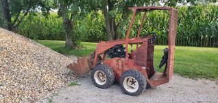

From what I can tell it was sold as an IH4120 in 1978. It would have had a Kohler 16hp on it. It has a new 18hp Duro on it. I am not familiar with that brand. It runs good. It needs some work done on one hydro. Everything else has been rebuilt. It has some sort of quicktach on it but it's non standard. I doubt I'll do anything with it. Already have more capable forklifts.
