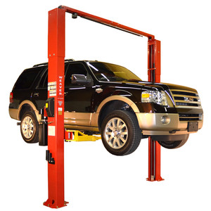

Personally I would buy a 10k lift and a certified one. I was going to buy this one before I stumbled upon a barely used rotary 10k just down the street from me. I'm not willing to take the word of a chinese manufacturer with something my life depends on. No affiliation with the company below but from my looking around it seemed like the best bang for the buck at the time.
