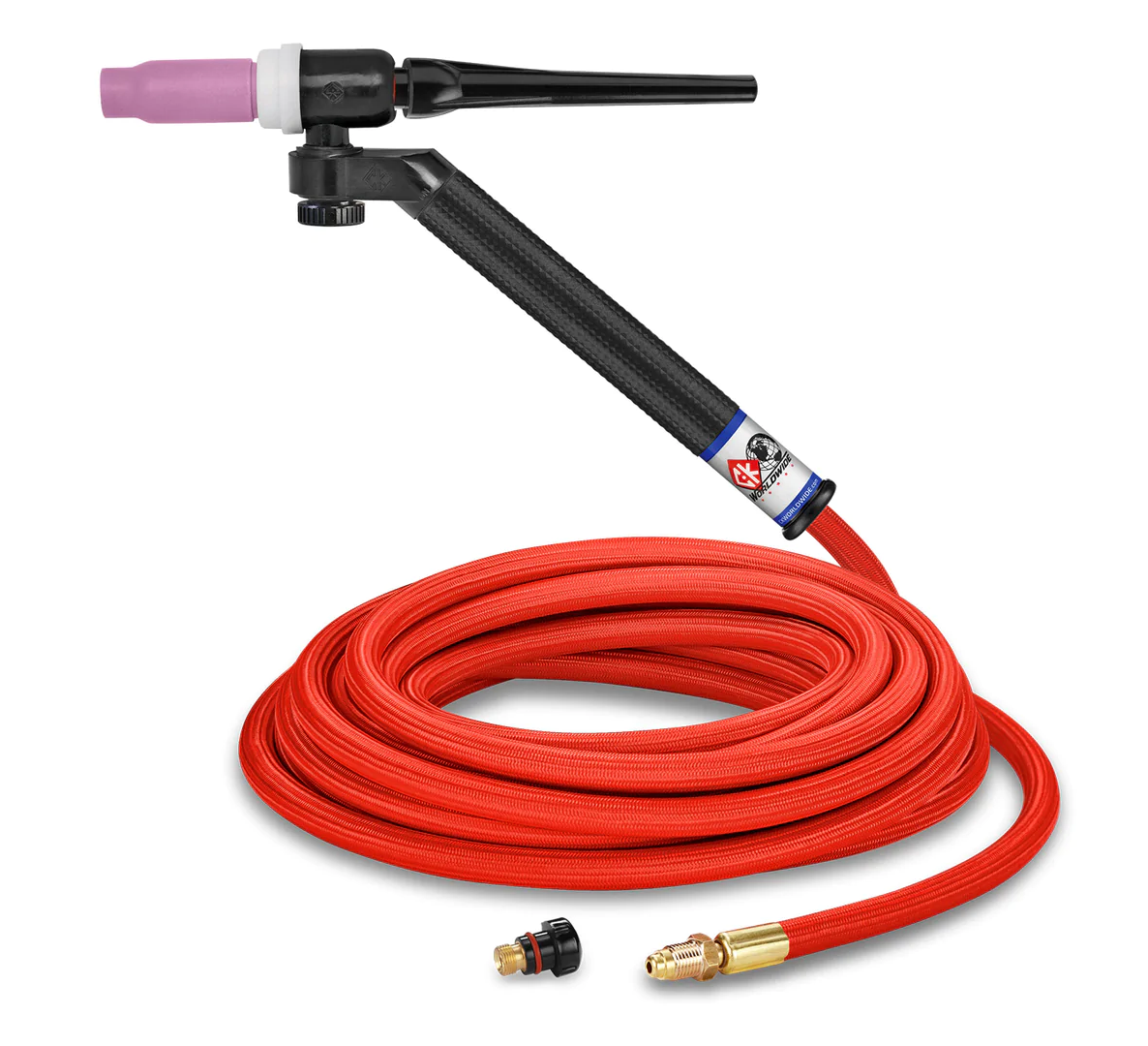

Here are a few pics of what I need to do and the current smallest torch I have.
I'm thinking about a CK micro MR-140.
Does anyone use or have this torch and can comment on it?

ive had the ck watercooled micro for couple years. its ok but if i were doing it over then probly i would go weldtec micro watercool. it has flex shaft version and i like the head design better. also they will custom make different shaft lengths. perhaps i may even just buy the weldtec micro one of these days. its amp rating is just 125 where as the ck claims 140 but theyll go above the rating without any trouble and you can mix in helium to make it a super micro. thats what i did.
i dont use the micro everyday or even every week but its been a great addition to the stable. some people may never have a need for one.

Well I picked up the CK MR140 micro.
I ran it only for a few minutes to try it and I'm really liking this torch. It really is small and can get into some really tight places. I need to pick up some quick couplers for the water lines to make easier to switch between torches. I was a little disappointed that is didn't come with a protective sleeve for the hoses but other than that it is a nice addition to the shop.
I won't get back on this job until after next week but I'll report back once I have used it a bit.

I'd be interested to know how the tungsten retention works on that torch? It appears there's no back cap, so do you have to cut each tungsten to length?
