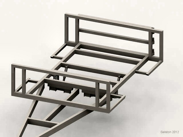

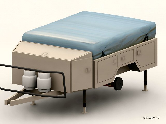

As I suggested while waiting for my shed build to start Ill post up some projects if I can find the photos.
This one is easy as it is already well documented so a simple copy and paste from another forum works..........
This dates back to around 2011-2012.
__________________________________________________

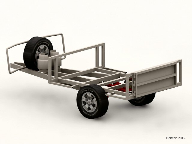

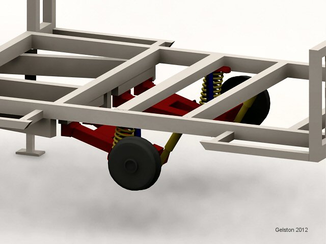

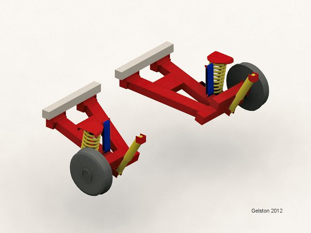

It started as a design concept, didnt really turn out exactly like the concept but you get the idea ;)
No special modelling skills here just real basic stuff.
I think its fair to say even the virtual designs are subject to change and in my case they were changed quite a bit after going to the camping show and seeing what I wanted. I didnt bother to make the changes virtually because I completed the cutting lists and designs on paper....its easier to have out in the shed with me!

The trailer like all trailers, started life as a pile of steel on the floor.
The draw bar and chassis is all one piece, I had rollfab in Hobart roll the steel into shape for me. He didnt do it exactly to my drawings but I let him off and worked with it anyway.
And not long after it started to take shape. All pretty simple stuff really.
I tend to over engineer at times but I was concerned about a slight kink in the steel where the metal roller rolled my chassis/drawbar shape so I put a nice sized gusset in that area.
I should mention the main section is 100x50x3 with the rest being 50x50x3 all blue steel except all the top section or any other non structural area was made with 50x50x1.6 gal.

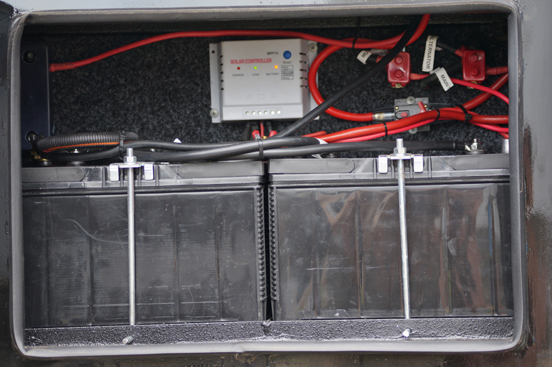

Battery area with only one battery at this stage. It also has circuit breakers from anderson plug at front of trailer and a circuit break for the battery charger. It also has a circuit breaker/isolator for the 1000w inverter. Where all this screws down is being replaced with a stainless sheet once the camper is painted.

The vented Battery compartment house 2 x 105ah deep cycle batteries, circuit breakers, solar controller, gauge shunt and inverter switch/breaker.
The other electrical compartment holds the 240v smart charger, isolation switch, fuse box and some water elbows.

Danshell that is one awesome Camper Trailer, many thanks for sharing:bowdown:
Thanks. There has been a lot of refinement of every area over the years to get it exactly how we like it.
One person can set it up in 10 minutes easily which is perfect for us as we now use it all the time. Especially since installing the diesel heater :)

Trailing arm IRS ! Not really hard to build and it gives you a lot of suspension travel, independently. Very cool. I'll bet it works great on rough terrain.
Yes it does work well on rough terrain and it rides very nice in general use.
The camper has version 2 suspension under it now as I slightly under engineered version 1 and bent it in the worst possible place in outback Australia, but thats another story.
