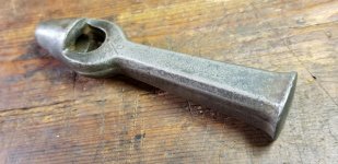

I found this double bow trimmers'/upholsterer's/saddler's punch at the flea market today. I have a small collection going, different sizes, mainly Kraeuter, Osborne, and a few offbrands. It was too rusty to identify the maker on the spot. After cleaning, I can see that it's marked "[A.S.F.&T. CO.]" on one tang and "[ELIZABETH, N.J.]" on the flip side of the tang.
Does anyone have any insight into that acronym?
I am guessing the F. & T. might be Forge and Tool, like Utica Drop Forge & Tool, and they actually used "U.D.F.&T. Co." as an acronym in their branding and markings.
But I can't match A.S.F.&T. Co. up with anything available on the GJ Vintage U.S. Mfgrs list, Tools Archive or Alloy Artifacts, and some initial searches have come up nil.

I have one very similar to yours with the same markings. Mine has a "C 1" on one side. The size is approximately 5/8". I believe they are called an "arch punch" and are used for mostly for leather and other soft materials. I picked up mine at a flea market for a buck with the intention of using it for gaskets and plastic, but really haven't needed it.

Yeah, same thing, SuperCat. Double bow punch is an older term. And yes, they will cut a hole in leather, canvas/duck, and vinyl, and I have used them on tin with a good backing.
The size marking on mine is tough to read and I haven't measured it yet.
With only initials it's difficult to use search engines to look it up.

I believe you are looking for the American Swiss File & Tool Co. of Elizabeth NJ.

Nice shot, DadsTools!
You're going to laugh (I did, anyway, right after I kicked myself), and I will probably take some ribbing from my WWII collector buddies. I compiled and actively maintain/update a list of US Mfgrs who I have verified through at least one of two sources as US Ordnance Dept Suppliers during WWII. The list is in alphabetical order. One guess who the first name on the list is! :lol:
You can see the list here if you're interested.
In my defense, despite the "Tool" ("T") in their name, I have put them strictly in the file room in my mind, and seizing on "Forge & Tool" for the "F. & T." didn't help undo that erroneous confinement.
Now I am doubly glad I grabbed this cutting punch. Thanks!
