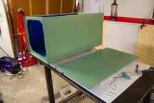

Next up was the paint booth + hardware + clothes storage corner.
Gave the wall some fresh paint and set about building a frame.
What I did was I mounted one of the cabinets into the wooden frame, then cut the back open, this way I have 70cm of depth instead of 40 cm. Notice that I do not have any bottom threshold. I plan on having a rolling paint storage cart in there that goes up to half way. Above will be a paint booth (100x70x100) with filters and fan extraction. If I need to paint larger items I can (in theory) simply roll the paint storage cart out and have 100x70x200cm.
A
adanielsson
Aug 4, 2015
33
Gave everything some green paint via roller which worked out much better than anticipated.
Added the drawers again, was planning on painting them as well but I kind of like the contrast for now. Will replace the filing handles though from plastic to matching metal ones.
This meant I could finally begin sorting out some hardware into the cabinets..
I just realized I have not taken any picture of the whole unit with the painted doors yet. Will have to do that tomorrow.

Made some more progress these past week.. Continued with making the main sheet material storage.
Some paint on that..
This is what I aim to get away from, cutting stock on the floor. I like the new metal band saw though.
Pardon the mess.. again. I'm sorting this garage out one end at a time.
