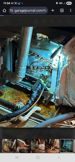

I had a problem with my air conditioning system that froze. Had a tech come out and put 3 pounds of 410 an into the system, along with a leak stopper.
The unit itself has a drain and that drain appears to be draining outside my house.
My drain pan cannot properly be pitched so there is no drain attached to it. I’ve been checking it over the past day since the unit has been put back into service and there’s quite a bit of fluid building up in my pan. I’d say I’m getting about a gallon every 12 hours. I’ve been removing it with a small wet, dry vacuum.
My question is is this normal? It’s been pretty hot here and it’s pretty warm in the attic space where the unit is. I never really paid much attention to it as long as the air conditioning is working so I don’t know if having some fluid there is normal. I guess, as long as it evaporates before it overflows the tray I never would’ve noticed it.
Next question is, is there a pump that I can put in there that will automatically turn on and off to remove the buildup of fluid in such a shallow pan? I’d say it’s probably about an inch deep max. I do have an outlet there. I can plug into then I can just run the tube out the same hole where the main drain for the unit is exiting the house. Ideally this pump would just sit in my drain pan and have some type of float so when the level got to say half of an inch it would pump out and turn itself off.
Thanks

I sure hope I'm seeing this wrong. Why is the condensate in the steel pan?
It looks like a traditional air handler flipped on it's side. The condensate should still be going through the internal pan and drain. Have you checked the pvc drain line?

10-4 The metal drip pan is for emergency use only. If there's water in there continually - or if there's alot of rust like here - then the primary condensate line/drain is restricted and the coil pan is overflowing into the emergency drip pan. That pan is there to prevent overflow into the ceiling and home causing $$$ in damage.
The main cond drain line should be low on the wall outside, probably near the condensing unit. It should always have water dripping out during the summer. The secondary pan drain should be high up on the wall outside in the same general area. If you see water dripping out of there, turn the A/C off and call for service.
The little gray device in the first pic with the red leads is the safety switch that should be turning off the unit if there's water in the pan. Can't tell if it's hooked up but judging from the rust I'd say it's inoperative.

The condensate drain is running uphill from the evaporator, because the unit is too close to the wall and cant sit high enough. Apparently someone tried to install it with the exising setup from a previous unit. It essentially needs a new installation to correct where it sits and all the piping (condensate, gas, venting).

This is an attic install that should be easy to get a PROPER gravity drain installed and draining. I see that you have a drain pan float switch installed and you can easily take that white PVC plug off that "stub out" and hook up a PVC "emergency" drain to drip outside.……. This way you will have a pan drain and a pan over flow shut off.
I highly suggest taking everything apart and start out fresh with some 3/4” PVC…… Pitched correctly.

The "trap" in the actual drain pan is probably clogged. Water should NEVER be appearing in the metal catch pan. That's there to protect the ceiling below from something going wrong with the real drain pain. The pan inside the unit is plastic, and is connected to that white PVC with all those 45's. The usual mode of failure is slime builds up in there until the trap clogs and the plastic pan overflows into the catch pan. At this point you need to shut the unit down and clean out the drain line. A vacuum might open it up, but a brush works best.
When you get access to the pan (after opening the drain), treat the condenser coil with self-rinsing cleaner, and that should wash the rest of the **** down the drain. Then drop a pan tablet "mint" in the pan to prevent new growth (for a few months).

I had someone come by to open the unit and remove the clog. It ended up being insulation that got wet and partially clogged the drain inlet. Surprisingly there was not much buildup.
He also rebuilt the condensate line. I think it’s working (not leaking) but I’ll know soon. There was a lot of wet wood so it’s drying.
The pan is drying up as well. Once it’s dry I will clean it well. And epoxy or flex seal it.

Looks your fixer notched the sidewall of the pan as part of the fix. 😬
Before
After. Note the black tape add
So you have less ponding capability and a hole in the pan. Make sure this notch is fully sealed tight to the pan.

The condensation line looks "right" to me, it's got a trap... But what does not look right is that they cut the pan. That pan is going to leak where it meets the PVC. I'd fiberglass it or find some other means to bond PVC and metal so it won't leak. If flex-seal works, all good.
If you want more security, you add a "float switch" to the pan. That way if the line backs up and the pan fills up, the unit shuts down. Beats replacing drywall.

Firstly, I have had guys come to my house , see this unit and leave -LOL. Out of shape old guys (like me). You need to be a contortionist to work on it. This person I found was not the original installer. I have cut ties with him as I have had many issues with his work and prices. This unit is against the joists so it cannot move back or up any further.
You are not wrong he did re notch it to get a slight pitch. It was notched prior as well. getting a new pan is not easy or cheap. Whole unit would need to come out. So its just about impossible. Its too big to slide out although it can be shifted when the drain was out. He used a gutter repair tape to seal from the outside. I will clean it and silicone the corners. Also build up the area where its been cut and repair the old cut out we bent back with flex seal tape.
The drain now has a clean out, and has a positive pitch to the T and out of the house. The unit was opened for the first time since it was in stalled in 2012 and cleaned out totally. Mostly dust, insulation from install and some gunk. All told it all fit in an 8oz coffee mug but the wet insulation plugged a good part of the drain.
When he resealed the door with the silver tape we have a leak on the bottom of the area where the duct meets the unit. It was wet and the tape did not stick. He will be back in about a week to see how well we can seal that up. That said the unit is working great, draining great and I am super happy for what I got and what I paid. Not often i feel that way these days.

I'm not an HVAC guy.
Is that right side the intake/return?
Why is the coils small end toward the intake if thats what I'm looking at. I have no idea and just trying to learn.
If its the outflow side why would the drain be on that side? It seems it would be pushing condensate into the duct.
I noticed you said there was wet insulation inside and wondering how it got wet.
I had a similar situation on my unit. When the main drain line got clogged and the unit wasn't plumb. It was sucking condensate upwards into the insulated cabinet and pushed it into the ductwork.
Mine has a overflow drain hole (higher hole just above the main drain line hole) .
I can't see an overflow into the pan. How does it get into the pan if needed? Is the plug in that hole still in?
Also that stub out in the pan should go outside.
The unit has a "internal" drain pan that sits under the coil and catches condensate…….. That is what the OP had "fixed"
The sheet metal pan under the unit is an emergency (secondary) pan…… Hack job!
That "stub" COULD go outside but since there is a overflow float switch installed you don’t have to run this emergency pan to drain outside to a "visible area" like over a door or window……… I highly suggest that these overflow drain pans to go outside as "back up" to the float switch.
Condensate "coagulates" and drains will clog because of the dust being sucked in to the unit and sometimes a bug will build a nest inside the PVC drain………A high end furnace filter will help reduce the dust being sucked in and mixing with the condensate but regular MAINTENANCE is key and only takes less than 15 minutes with a shop vac and doesn't require special skills to open the unit and drop in some pan tablets.
NOT to bust ballz but "IF" the OP did maintenance the clogged line "MAY" have been prevented.…… Same goes for condensate drain lines and sunroof drains in a car.
Hope this helps! C
I understand that there's an internal main pan.
I was talking about the overflow pan and that I don't see a overflow drip tube from the unit to the pan. On mine there is the main drain from the unit. Just slightly above that on the unit is the overflow hole which has a pvc piped out and down to the overflow metal pan.
And yes whether there's a float switch or whatever that overflow pan needs to be piped outside. Switches fail and in that case will overflow the metal pan and will be a huge mess.
No idea but down here we pull tons of condensate out of the house. Clogged main, bad float switch and that overflow pan would topple over in a matter of just a couple hours or so.
The code says that you don’t have to install an overflow pan drain if you have a shut off float switch installed……. I have a pan drain along with a float switch on my units.
Do this.
Code allows them to dump condensate into a sink drain also. Which works out terribly every time in my state. That drain clogs, it fills the downstairs sink and you have overflow. It's just the dumbest thing ever. It's just "pass the buck" on what overflows. Stupid stupid stupid.
First thing I did in this house (before drywall) was remove their darn AC feed to the master bath sink. Ran a dedicated line.
Here, condensation lines get clogged "frequently". If the AC guys didn't do a good job on the pan (as in the OPs case) or if you don't notice the overflow path, this can be 10k+ in damages. A cut off switch, in my opinion, is cheap insurance. As is adding chlorine tabs, which last way longer than than the "tabs" that sit in the AC unit.
Exactly. You have both. Redundancy. 1 is none 2 is one.
Yes mine has both too. I don't really care what the code says about that. I'll have both required or not.
OPs at one time just had a float switch and no overflow to the outside and just a little capped off stub.
Not sure what is has now. I'd have yo go back but I thought the float switch wasn't connected anymore.
Yeah. They did that with mine 20 years ago. "OH yeah thats the way its always done"
Heck i didn't know any better.
First few days in the house i kept hearing this blewk blewk blewk blewk ....
Wth ? Wth is that?
Tracked it down. It was the condensate dripping into the P trap in my MB sink.
They came back and rerouted the main drain into the only available pipe which is the vent for that sink up in the attic.
