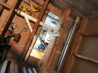

It’s been a few weeks of waiting for supplies to arrive. 4 weeks after ordering I found out that the Kohler shower pan was not going to arrive until December 12th!
The supplier suggested another brand which would come sooner. It arrived Friday and I was all set to get it installed and also finish the cement board this weekend, but there was one small issue...
The unit was described as 48” wide. (Same as Kohler unit)
To be safe I framed he walls slight wider at 48-1/4”
But the shower pan is 48-3/8”
I suppose I could grind one edge but I don’t want to risk breaking it. I’ll be on the phone with the manufacturer in the morning to get this resolved.
So I decided to start work on the drain line. The original was 2” copper but the pan requires PVC. PVC is s bit wider than copper which is an issue in this case since the drain is right up against a joist.
The top of the joist was chiseled out at an angle to make room for the original drain which had a couple 45s to keep it tight.
The new drain will require I notch out the full joist width (and most of its depth) to make room.
So I’ll sister a 2x10 to the opposite side and use PL construction adhesive and some carriage bolts to secure it.

I talked to the manufacturer today and they say the product is technically to spec since the dimensions may vary +/- 3/8”.
(That is noted at the bottom of the second page of the spec). They say I can grind down one edge safely using 36 grit or notch out the bottom few inches of the studs at one edge.
mattblast
Jan 30, 2013
784
Bridgewater, NJ
Trimmed off 1/8”’on each end of the shower pan today. It came off easily with a belt sander.
I was afraid to take off too much so I measured every few passes and brought it up to the bathroom to test fit a few times. Now it fits perfectly.
But floor was a bit too bouncy so I removed it.
It was only 1/2” and top lamination was water damaged so maybe 3/8” effective thickness. It’s all out now and I’ll replace with a sheet of 3/4” plywood then continue putting in the shower pan. A bit of a detour and I hate to do more demo especially after drywall is up but it will mean a sturdier floor.
The open floor also gives better access to finish up the plumbing and to sister on the joist which I hope to have completed tomorrow.

Had to cut back the copper drain line another bay to make room for the wye to the vent line. It took a few hours and over a dozen trips down to the basement to grab tools then back to the 2nd floor bathroom. Then a trip to Home Depot for a pvc slip coupling for the final connection. I worked non-stop from 9am until 8pm. It took way longer than I expected.
Also got the new joist sistered so I could cut out a section of the old one to make room for the trap.
Then got most of the flooring down (glued and ring shank nails)
There is zero bounce in the floor now.
Tomorrow I should be able to get the last piece of flooring in, and if time permits I’ll set the shower pan in a mortar bed.

Home Depot stocks it, but only in siliconized latex. They do make the same color in pure silicon but it’s special order. So I had to wait several days for it to arrive (free shipping to local store). Latex colored caulk was about $8 and the silicon was about $14. I almost went ahead with the latex but there is no need to rush the project since there is still another 2 weeks before the vanity finally arrives.
This caulk was impossible to get a good bead with - it just took too much pressure to come out even after piercing the inner foil a dozen times. I never had s new tube behave this way. To compensate I taped the edges and worked the finished joint with denatured alcohol to get a nice finish. I used a new technique - instead of dipping a finder in the solvent I misted it onto the joint using a spray bottle then shaped the joint with my finger. When misted with the denatured alcohol the caulk won’t stick to your finger and you can slide along it for a perfect shape.
End result looks great and it should last many years before needing to be recaulked.
The joint between the floor and shower pan was done with standard white silicon caulk. This was good old GE brand and came out of the tube with the normal amount of pressure.
The next day I started the finish carpentry. I like to cope the inside corners for best results. Takes a little more effort but I’ve done it so much that it only takes a short time to do each joint.

The replacement vanity arrived! I opened up the box and found it had a dent in exactly the same spot as the original. The dent is smaller and I’m not willing to wait another 6 weeks so I installed it.
It’s a small dent but I paid about $1000 for this and have been waiting since October when the original damaged vanity was ordered. Kraftmaid needs to protect the front edges better for shipping.
The first step was to position thevanity and level it. Then I transferred the measurements for the pipes and the outlet then drilled and cut the holes after double and triple checking my measurements.
Oops!
Turns out that I measured to inside of the electrical box but then used a box extender to trace for the cut. But I traced the outside of the extender not the inside. So the cut was off by 1/2”. No one was home when I screamed out a few profanities.
A few pieces of 1/2” plywood were glued in place and with the cover plate you cannot even see the mistake.
Once the vanity was in position I was able to measure for a 2” spacer. The wall and vanity were both plumb so no scribing was needed. The designer at Home Depot kept insisting that a spacer wouldn’t be needed but then the door would be very close to the wall. I planned on a 2” spacer and had the mirror and light positioned with that in mind.
Next was the trim behind the toilet, then fill holes and caulk and finally paint. Then the toilet could be installed. I was tempted to be the first to use it but decided to give it a test flush first. The bowl just filled up and never drained. That’s when I realized I left a towel stuffed in the toilet flange! Vacuumed out the water from then bowl and tank and pulled the toilet. Removed the soggy towel and re-secured the toilet.
Next is installing the shelves, ordering a countertop and installing the shower doors (ordered 2 weeks ago and should be ready in another week or 2)
I did put up a temporary tension rod and curtain so we can start using it.
