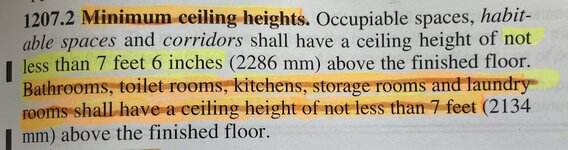

My understanding is that California and Oregon have adopted the 2018 International Building Codes. The following pics are from the 2018 IBC Manual. Disregard the excessive hi-lighting as it is the remnants from my taking the commercial building code test when my county adopted the 2018 building codes. My 2 cents is it sounds like your bathroom is for private use not open to the public. This exempts you from many of the ADA requirements that apply to bathrooms that are open to the public or employees.
I think to be on the safe side, I would adhere to the clear floor space specifications
There are also minimum ceiling height and room dimensions that might apply. Based on paragraph 1207.1 your bathroom may need to have a minimum dimension 7'x7'
Grab bar specifications
Bottom line, if you have an ADA approved toilet, grab bar, ADA approved sink, and the specified clear floor space, I don't think an inspector is going to give you much trouble for a private bathroom. I don't see the sink outside the bathroom being an issue as long as its an ADA compliant installation.
I recently kinda went through an ADA bathroom situation with my city regarding a commercially zoned property I'm renovating and plan on living at. At first the city was telling me that because the property was commercially zoned, the bathroom in my private residence would have to be ADA compliant. After much wrangling it was determined that even though it was commercially zoned, it has an R3 occupancy designation and that I would not have to comply with ADA requirements due to it being my private residence and not open to public or employees.
