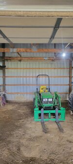

I plan on finishing the inside, which is why i want to change to an overhead door20220523_162202.jpg20220523_162122.jpg

I think what you really want is adequate framing to just mount a door on. Could be substantial but naturally you need to tell us some details about the new door.
What you have there is kinda under built just to be honest. That end truss was never meant to hold that door. Obviously it worked out.
