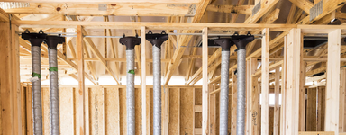

a single 4" flex duct isn't going to cool much.
a system of small ducts is different:
but it sounds like you have a single dryer vent trying to cool an entire room.
