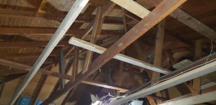

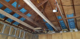

How about a few pictures of what you are working with ?
Here's a couple pictures of what I'm working with.
With everyone saying I should be able to use a single board.. I got the wife out there with me and gave it another try and was able to get a board up so I picked up the rest I need and got those up, it'll probably be a week before the wife talks to me though.. lol

The Cobbler
Oct 24, 2013
25,967
everyone saying the rafters should fit... well the roof pitch is probably working against you , by time you lay a 2x on top of the top plate, the joist end is probably hitting the roof deck because of the angle of the beast .
BigGarage
Jun 5, 2019
2,347
Just south of Detroit, MI.
I spoke from the experience of installing 14 20+ footers. The only problem I had, besides working alone, was the roof joists spacing stopping the joist from going into place easily until I cut a little more off the end. Once I had a length I just cut them all the same. The roof deck didn't come into play because I angle-cut both ends of the joist.

Does the roof line have a double hip front and back? You may want to add more supports the other way before you drywall.
There's no double hip, the first picture is towards the back of the garage, the second is showing the side.
As to the type of wood.. I was limited to what was available. I checked with 4 lumber yards and 2 big box stores, all had the same. I'll be adding some webs to prevent sagging.

After taking a closer look at your pictures it looks like your rafters a sixteen inches on center. I would buy enough joists to match the rafters. Not have one land inbetween rafters.
