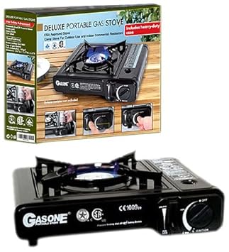

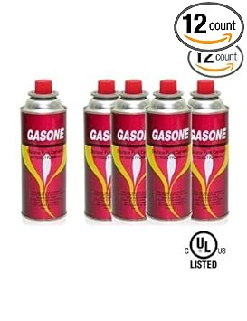

I have a wide electric griddle ($19 at Walmart) and a single burner butane cook stove and spare butane bottles, both stored away for emergencies. The butane burners are commonly found at Oriental groceries for some reason.
Lots of cooking options.
Electric frying pan (mom used one virtually every day)
Fry Daddy or similar
Microwave
Toaster oven
Electric griddle
Electric single burner hot plate
Crock Pot
