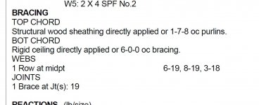

My first post here so please be gentle. We are in process of getting a nice 24’X40’ garage/shop built. It is constructed with attic trusses and there is a nice 10’ wide area running the 40’ length of the garage/shop. The garage/shop walls are constructed with 2”X4” (16” OC) whereas the attic trusses' bottom chord are 2”X8”, top cord are 2”X6”, and webs are 2”X4” (24” OC), the flooring is 23/32” thick, and the roof has a 10/12 pitch - see attached. I have nothing yet in the garage/shop because it is not yet finished though I do have a question for the experts here. I think that it would be wise to add some additional support to the areas in between the trusses (for additional flooring support). I have searched through the garagejournal looking for similar questions and did not find anything definitive. I looked on the Internet and found loads o’ stuff but some of the information seemed to conflict. What I thought would provide additional support/strength would be to add bridging but another site stated “Bridging is the term used to describe blocks nailed between joists in the middle of long spans. Bridging does not, as is commonly believed, do much to help stiffen a floor.” (http://www.saratogadeckpool.com/DeckManual/part4.htm). Yet another site states “Floor joist bridging is critical to the structural strength of a floor,…. Proper bridging distributes the load on the floor to other joists and over time prevents floors from sagging and squeaking do to floor joists twisting and warping.” (http://www.renovation-headquarters.com/floor-joist bridging.htm#.UXmh-spQggQ). I thoroughly understand that the trusses are an engineered item and I will not be modifying the trusses themselves, I am just wanting to add some additional support because of the 24” between the trusses.
I did read the ENTIRE thread here (http://www.garagejournal.com/forum/showthread.php?t=88914&highlight=bridging) and, although it appears that this is a very good approach and stiffen the trusses, I am looking to add support to the attic flooring itself (the 24” span between the trusses is troubling me). There is currently no flexing or 'give' to the flooring when walking across it. So, after a rather long-winded introduction to my question, here it is… Does adding bridging between the bottom chords significantly add to the strength of the attic’s floor?
Thanks,

Simple answer is no. You should be good to go unless you are storeing anvils up there. Somewhere in your plans there should be a live load spec for that floor if that will make you feel better.

In general, bridging/blocking will not increase the overall strength of the floor. What it will do is to help distribute point loads (such as a person) across several trusses. This will make the floor seem less bouncy.
Also, the bridging/blocking wi prevent the bottom cords from twisting under load, which will add some strength.
Your truss manufacturer may specify that blocking/bridging is required. I know the sheet on my trusses specified either blocking, bridging, or a rigid ceiling.

Precision cut installed blocking is called pressure blocking. While it may not add significantly to the live load, it will make for a more solid floor system. Pressure blocking does distribute the load. I would certainly do this at the outside edge of your flooring. Since it's only 10' of attic span, I would ignore the center assuming you are using T&G.

Blocking or bridging will NOT decrease deflection. In fact, you are adding a bit of dead load which will slightly INCREASE deflection.
The extra thickness of your attic floor sheeting accounts for the 24" span and your finished ceiling below replaces blocking or bridging as a method of transferring point loads to adjacent structure.
I like solid blocking over "X" bridging, but it makes it more difficult to run wiring or piping.
And any extra structure adds to the dead load and requires more strength (And structure and even more dead load) to support it.
I dislike most attic truss solutions since they place walls at approximately 1/3 points of a very long span and give only about 1/3 usable space compared to the floor below. I would rather just add a story.
Long spans require deeper members to get rid of that bouncy feeling. I always go deeper than the span tables to account for that. And long span floors aren't for heavy loads.

Perhaps you are mixing up some terminology here.
Certainly, if you decrease the distance between supports for the floor deck, you will have less deflection in the DECKING material. But what this means is that you must space the TRUSSES closer together. Your floor decking is already thicker, to span the 24" space, so this is not necessary. If you did want to add additional floor support members in between the existing trusses, they would have to be either additional trusses, or a member designed to span the same total span as the trusses do (From outside wall to outside wall).
Bridging or blocking runs perpendicular to the trusses. It gives NO additional support for overall loads. It DOES transfer loads between the decking and bottom chords of the adjacent trusses. It does this in a way that makes the floor feel stiffer.
Are we clear on this?

A load must travel from the floor deck into a truss bottom chord and then into a vertical wall and into the ground. Think of everything as a beam. The floor decking is a beam that transfers a load across the space between truss bottom chords into the truss bottom chord on either side. Solid blocking can help do this in a particular spot. Now that the load is supported by the trusses, nothing increases the load supporting capability of them except closer spacing of the trusses or stronger design of the trusses themselves.

The specs on the trusses were if you were not to use a floor than bracing every 6.5 ft was required. For the small cost of lumber, I went halfway between the 2nd floor walls (floor edge) and the outside edge. Or think of it like this, half way between the floor and the edge and the roof, so the bracing made a tri-angle of sorts. The 3/4" Advantech was glued and nailed which helped to make a somewhat rigid structure.
No bounce at all, except for the slight flex of the subfloor. that will change when I install sanded plywood for a finished floor.
