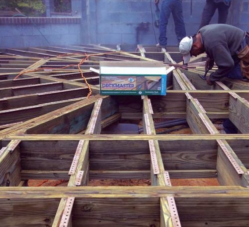

Personally I don't like clips or biscuits or whatever that sit between the boards, EXACTLY where you want clean, open air. And not debris and moisture.
I've used deck master rails. More work, to be sure. Apply the rails then all decking screwed from below. But for me, labor is cheap. ;)
Once decking is installed, the space between deck boards is open, can be power washed, blown out, cleaned with a scraper, etc. Not an issue here, but water then ice cannot get into that joint either.
I **DO** like the idea of a moisture barrier on the top of the joists, as you described. Even with PY lumber.
Here are some desk master brackets installed- lay boards on top, screw up. Two screws per board, easy to reposition if needed. I had a 12" pony clamp to hold them when son was in school (his job was to 'stand here') ;)
Ard, the Moistureshield composite I used is rated for water submersion..so no worries there. The Mantis clips maintain controlled spacing between the boards (about 1/8") and also elevate the boards off the joists, so maintaining an air gap under. They are not inexpensive..but they are the best solution I've used yet :)
