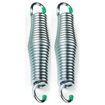

You guys are so overthinking this. 3/8" eye lags with a 375lb SWL (and well more) are easy to come by.
Use the stud finder to give yourself an approximate location, and then probe with something pointy to properly locate the edges of the joist, from which you can deduce the center.
PRE-DRILL before installing a lag, so you don't get splitting.
Hang a COMPRESSION porch swing spring from the eye to reduce any shock loading.
Get the compression type that cannot easily snap:
3534197
and NOT the expansion type:
And then enjoy your *** swing, or whatever you want to call it.

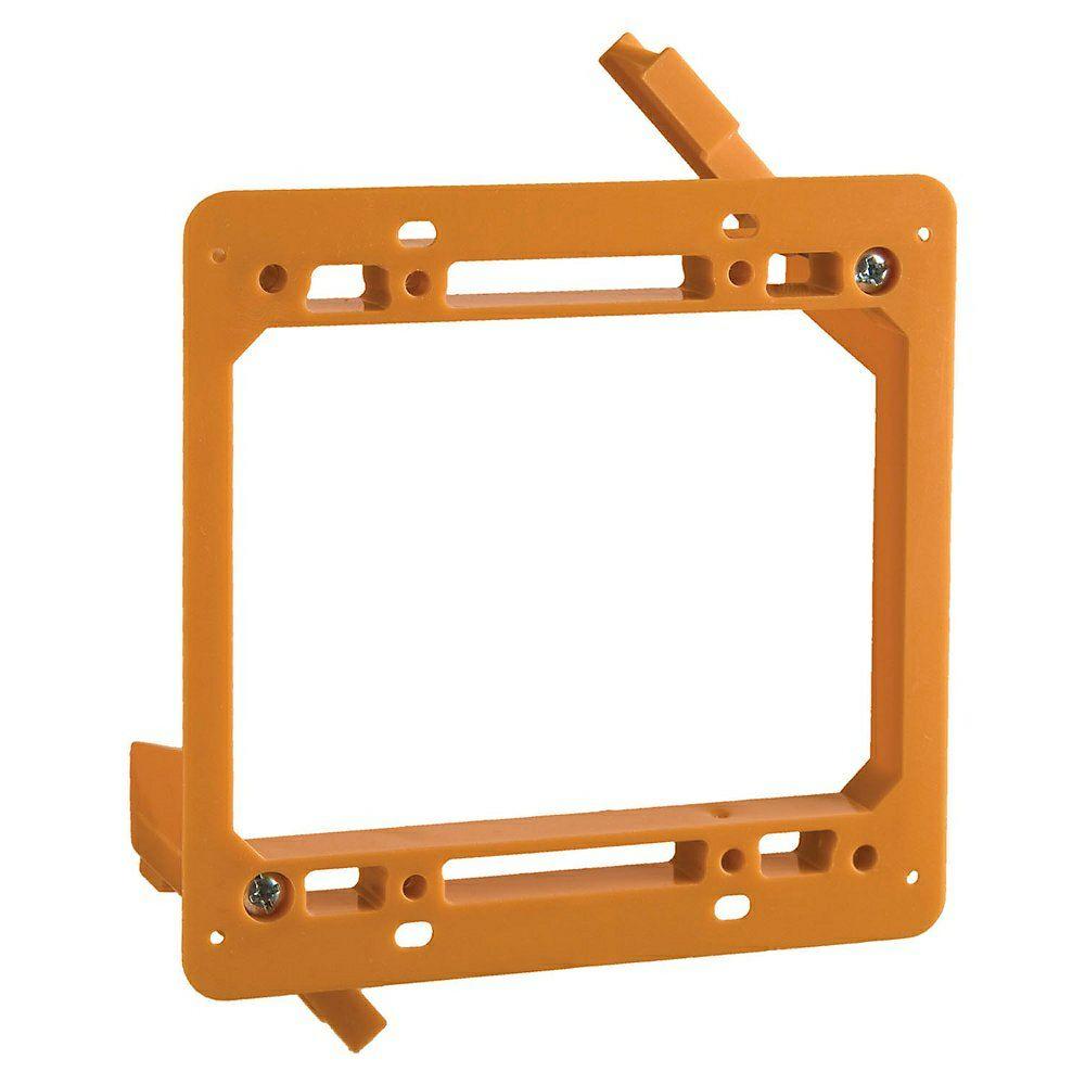

As for getting the nut on top, you could easily cut a hole to fit one of these:
reach in with your hand to get a nut on, and then cover with a blank electrical cover plate.

Those are going to feel great when the dinky 3/8 eye pulls out and they smack you in the chest.
