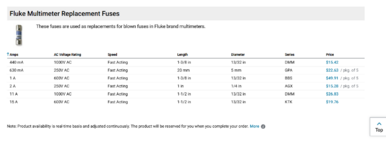

So fuses are an exotic alien technology known only to Fluke?
Riiiiight.
Wish I had known that. I've revived more than one mid-market meter with a fresh fuse and a screwdriver. I even recall finding a handy spare fuse in one when I opened it up. Craftsman, I think, made by who-knows. But it was (and still is) a perfectly cromulent meter.

I'm with you there. Had a few ($40 or less) Radio Shack meters in the past and they had a spare fuse in the battery compartment with a small pull ribbon to remove it from the fuse holder. Also had a Fluke and managed to blow the expensive fuse a couple of times just with household voltage.
Fuse availability can be a pain in the ***. My most recent meter is a Uni-T UT61D+ which after purchase discovered it uses BS1362 6mmX25mm sand filled ceramic fuses. Love the meter but had to search for spare fuses. Apparently these fuses are common in the UK where they are incorporated into the plug of the electrical cord. And like many things these days are also counterfeited so I avoided ebay sourcing. Ended up ordering some spares from Newark Electronics where the shipping exceeded the cost of the fuses. So it goes.

I looked at a couple of Flukes, couldn't find any Fused protection. SMH.
I had a Fluke 115 where the case must be taken apart to access the fuse inside. I think Fluke does this for safety to help contain a high energy arc. I don't think Fluke puts fuses accessible in the battery compartment. Others here could elaborate on this. That was my only experience with a Fluke DMM.

They generally put something in the user manual, if it had a fuse and where it is located. Your model does.
376 FC no mention of a fuse at all in the user manual.
AI
The Fluke 376 FC clamp meter doesn't have a readily replaceable fuse like a multimeter. It's designed with a different type of protection circuitry, likely involving solid-state components rather than user-replaceable fuses. Therefore, if you're experiencing issues with your Fluke 376 FC, it's best to consult the manual or contact Fluke's customer support for troubleshooting or repair.

Many cheap meters do not have adequate protection or a CAT rating. There is a discussion of one here: https://www.eevblog.com/forum/testgear/darwin-award-dvm/
As you know, adequate protection is much more than just adding a fuse.
Many meters other than Fluke have CAT ratings that they actually conform to. A good example would be Klein. But others don’t. And Fluke consistently has good protection.

Then you should be good:
Test equipment is rated with both a measurement category AND a voltage. The working voltage rating and the measurement category rating are both needed to determine if the test equipment will provide adequate protection for a given circuit.
The following table shows the overvoltage ratings for test equipment, based on category and working voltage. To determine the maximum overvoltage rating, find the row (CAT I/II/III/IV) that corresponds to the meter’s measurement category on the leftmost column, and then go across the row to find the column corresponding to the meter’s rated working voltage:
Working Voltage150V300V600V1000V
CAT I800V1500V2500V4000V
CAT II1500V2500V4000V6000V
CAT III2500V4000V6000V8000V
CAT IV4000V6000V8000V12000V
For instance, a meter rated CATIII, 300V can withstand an overvoltage of 4000V on a Category III circuit. As the rating suggests, it is suitable for CAT III circuits up to 300V working voltage. It is also rated as suitable for CAT II circuits up to 600V. It is not, however, suitable for use on CAT II circuits of 1000V, CAT III circuits over 300V, or any CAT IV circuits at all (despite the fact that it offers a 4000V overvoltage protection, which corresponds to a CAT IV circuit of 150V rated working voltage.

The Brymen I have has an excellent ceramic-lined fuses. It's CAT IV in a small form factor.
Here's an in-depth comparison of the Fluke vs Brymen.
