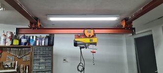

Here is my solution in the new shop
While building the shop, I encapsulated half of the I beam inside the reinforced concrete (not US, so different construction methods). The I beams run in parallel through complete width of the shop, while parts of I beam encapsulated in conrete are welded to rebar.
Two trolleys, rated at 1 ton each hold the transversal I beam on which an additional trolley is mounted, together with electric hoist rated at 800lbs single line or 1600lbs double line.
I think it definitely beats the unistrut solution few posts higher.

While yes definitely stronger and superior to the uni strut set up it is also not achievable in a wood framed garage and with the unistrut system roughly $500 compared to your system the unistrut will do the job for most people.
