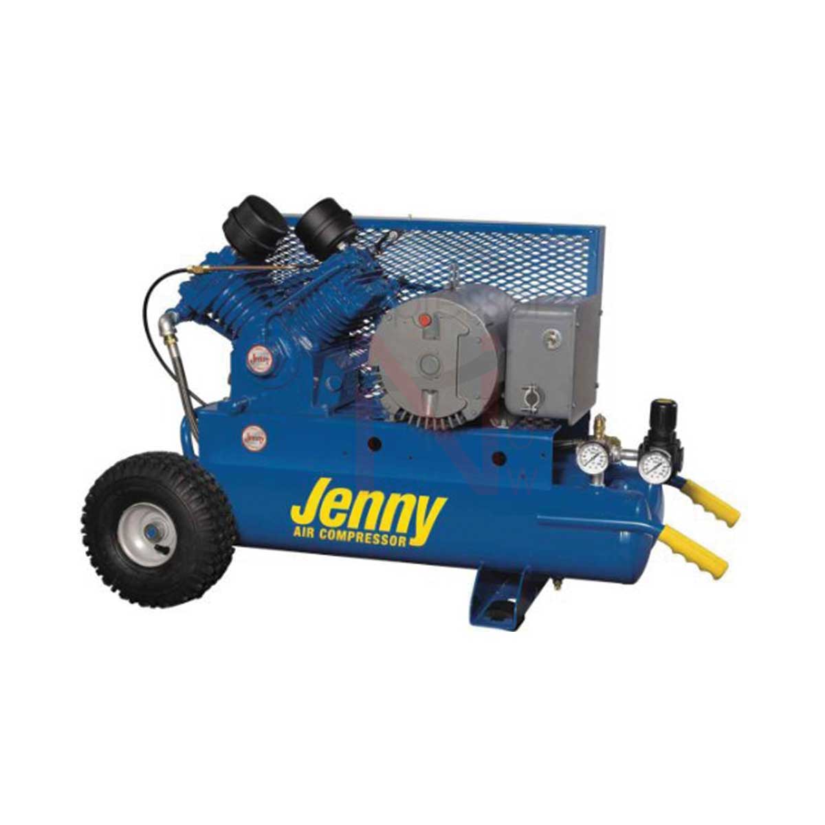

American Locomotive
Jan 8, 2017
11,026
Rhode Island
You might want to look at Jenny compressors. They make a variety of low profile, but high flow 240v compressors.
...but they are pricey.
