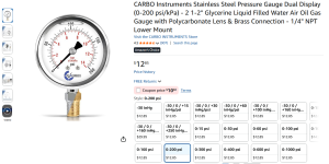

If it is NPT, then you need a NPSM pipe fitting with the internal seal on the male threads. Parker pipe fittings feature the internal seal band to seal on the ball inside the swivel nut.
the seal is made on the small flare so no pipe thread tape or sealant is required.
