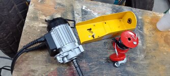

Ok guys. after thinking about this more.... and I just recently had a brain storm
I've got a small 120 volt hoist that I have never used. bought it at princess auto . I think I'm going to re work that for a drive . powered in & out. has a stop switch when the cable hits the end it shuts down . I can re work that to the air hose . it has a nice comfortable speed to it when winding in & out .

here's the small hoist I am sacrificing for this project . I'm actually not going to do any harm to the hoist & various parts , I can always resurect it back on the slim chances that I want to.
here it is taken apart . the hex shaft will fit into the air hose reel and drive it . I will probably slip a socket over it that is fastened to the tube of the reel so I don't have to alter the shaft

no pictures but I have a 13MM socket that fits the shaft of the hoist and fits nicely inside the reel axle shaft . The plan is to machine off the drive end of the socket so the hoist shaft runs thru it , and weld the socket to the axle shaft. that way the hoist shaft is not compromised in any way
