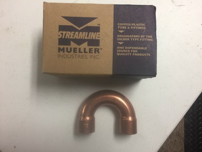

not as big a deal with air as it is with water, but every 90deg fitting you put in there is a reduction in flow rate.
And heck, if you are going to put a clear PVC flex line in the run, you might as well make it a drop loop and you'll SEE any moisture accumulation.
Drain your tank often. Compressing the air into puts the moisture in the tank. The air line out the top of the tank will provide air drier than your ambient humidity. Put a moisture trap on the tank outlet and you don't have to worry about the rest of the run(s)
