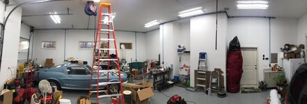

RapidAir 3/4" Fastpipe (rigid.) Easy to install and looks great. No issues yet (6 months from new.)8a9dbfedd21bd2ebbc9660386600f974.jpg
