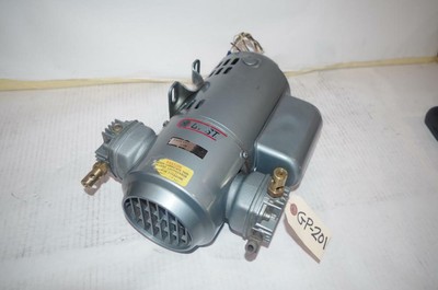

pcmeiners
Aug 13, 2009
7,900
Build from scratch, I purchased a few Gast pumps for projects approx $100.00 (Ebay), all were never used. Seen facemasks show up on Ebay.
