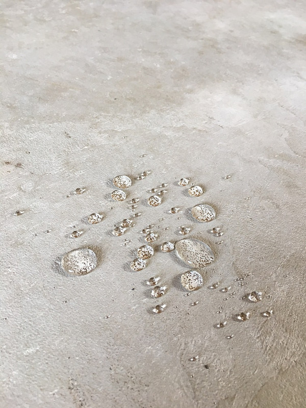

Why not just do densifier application and then a coat of sealant? Both are super easy to apply and it will strengthen and protect the surface.
I just finished the densifier layer and it took 10 minutes to apply to my 400 sq/ft garage. You have to wait 7 - 10 days before doing the sealant but, that should take less than 30 minutes to apply.
I'm using Ghostshield 4500 and 8510.

Look up GhostShield. I used that on my 30x40 last year when I built it. Very simple to install (sweep the floor and spray on with weed sprayer) and cost around $300 IIRC. The concrete does not dust and spills wipe up reasonably enough.

A densifier and Ghostshield 8510 would be one option: https://www.garageflooringllc.com/siloxa-tek-8505-concrete-sealer/

I didn't want to spend the $5,000 it was going to take to diamond grind and epoxy. I spent $300 on ghost shield 8510. put it down in a garden sprayer and it dries transparent. cant tell its there. The oil and water bead up like when you wax the hood of a car.

I used Eagle Natural Seal on the concrete slab in my barn.
It's available from Home Depot, less than $100 for a 5 gallon pail. Shipped to your door for free.
It doesn't change the look of the concrete, just seals it.
Water beads up nicely.
