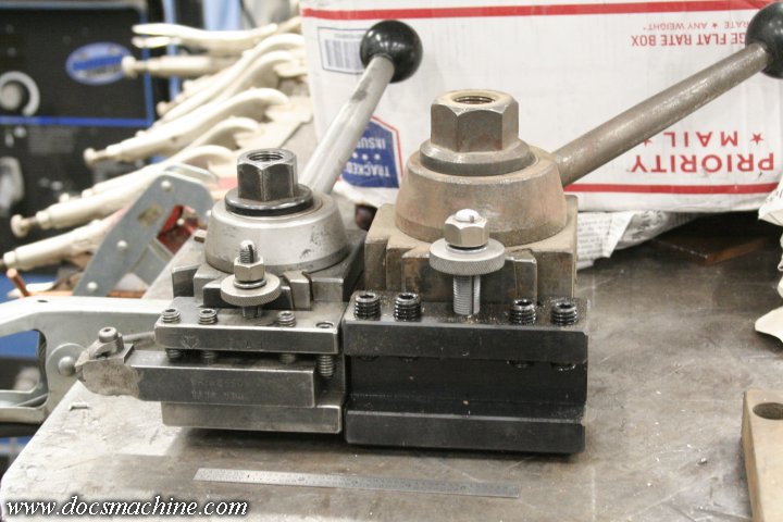

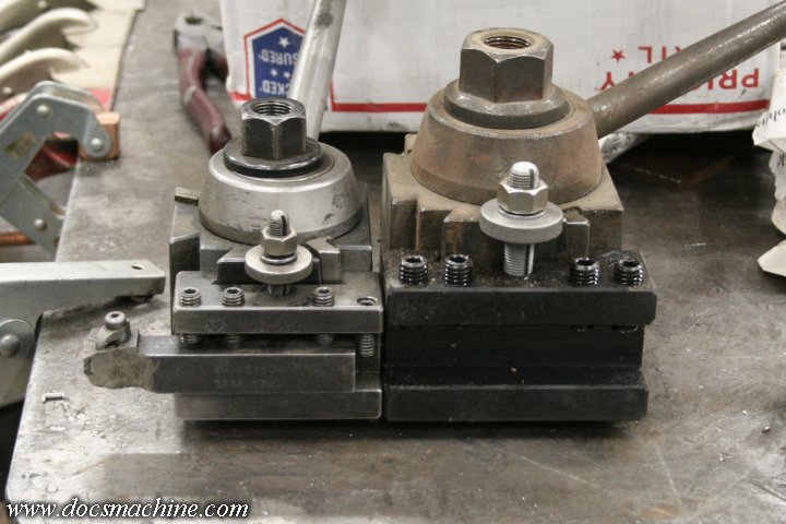

Some hard data:
Here's a pic of my CXA, on the left, with a tool block approximately where it would be for a typical indexible carbide tool. The one on the right is the CA tool post, with the block adjusted to about where it'd have to be to set the same cuter height using the same 3/4" shank tool as in the CXA block.
Here's the same setup, but with the CA block adjusted to about where it'd be if you were using a 1" shank toolholder, rather than the 3/4".
You can see we're starting to quickly run out of room at the bottom- the block can only be lowered about another 1/4" before it would bottom out on the compound.
Now, again, I don't have my machine together yet in order to try these in a full, proper setup, so take it with a big grain of salt.
I think I could/can use the CA on my machine, but I suspect it'll be a tad TOO big at times- clearance to the tailstock or live center, for example, when turning between centers. And I suspect it would be nearly impossible to use small cutters, like chunks of 1/2" or 3/8" HSS- which means for small features (like thin grooves) having to do a BUNCH of grinding on a big chunk of 3/4" or 1" HSS.
(I'd been toying with the idea of making a small handful of "undersized" blocks for the CXA, back when I was finishing up the machine- with a 1/2" AXA-sized slot at the right height the blocks would 'land' about the normal height for a CXA, but the smaller tool would still be on center.)

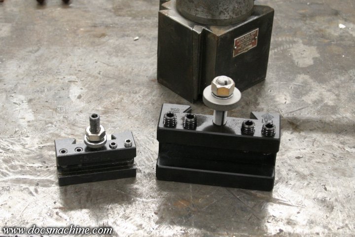

And just for fun, here's the CA block compared to an AXA (a very popular size for people with Logans, Southbends, Sheldons, 10EEs and a host of others.)
Anyway, I'll hang on to both until I get the machine back together, and see of the considerably more expensive CA is worth using, or even keeping.
