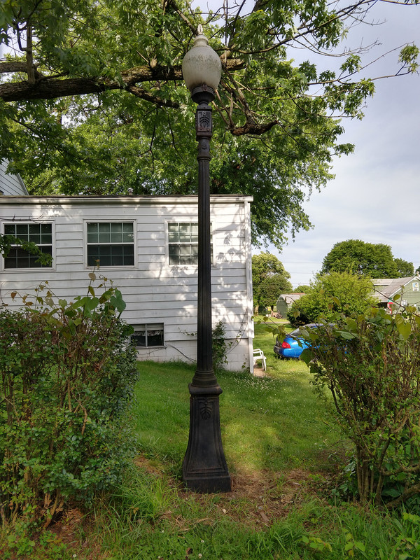

Back in June, I bought this lamp post from a friend of mine's daughter. My friend died in 1981 and it has been in the yard since the late 1950's. It, along with many others, were installed on Market St. in Parkersburg, WV.(across the river from me)around 1919. They were all removed and replaced with ugly overhead mercury vapor lights some time in the 50's. It is lost as to how my friend acquired the lamp post. Here it is before being removed with the picker.

It is 12 ft. tall and is a one piece casting and weights between 600-800lbs. Most of the casting is 1" thick with the bottom of the base being about 1 1/4" thick. That is an original GE glass globe.

I painted it with Rustoleum satin black. I don't like gloss for things like this.

I just realized I never posted the end result of my project. I think it turned out great.
