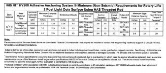

I'm having decision paralysis and need your help. I had another thread detailing my anchor issues on my new lift. I have to replace 3 3/4"x4.5" wedge anchors. The manufacterer instructed to torque to 150ft pounds. Now they are useless and no help. I get the feeling Greg Smith tech support are sales people with not much physical knowledge. I got the anchors out but the wedges are still in the holes. These are the options that I have. Perhaps i'm missing more?
A. Buy a 7/8 inch wedge anchor, drill a 7/8 inch hole but this time all the way through the floor! I'd have to buy the 50 dollar bit and maybe 30 bucks in anchors. This will torque to over the 150 pounds on the instructions.
B. Use Hilti 3/4 inch anchors with epoxy that i picked up. Due to their special applicator it cost me 300 bucks for what i need. I still need to buy the 7/8 inch bit per their instructions. But this can only torque to 110.
I suppose i could try the cheaper method of the anchor and if its an issue just pound it through and use the epoxy. I'm getting hung up on the torque amounts. I feel if i don't get that magic number and later it pulls out i'll be kicking myself.
