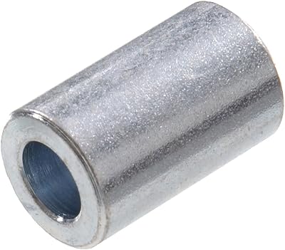

The gap between the drywall and the block could be a problem since you wouldn't be able to torque the screws properly. Torquing the screws properly may result in the drywall collapsing towards the block. Torquing the screws only enough to not collapse the drywall may cause the standards to "slide" down the wall when fully loaded.
What I have done before was core the drywall large enough at each screw location in order to install spacers to transfer the load to the block wall properly.
That's a great idea! That was another concern I forgot to mention and didn't know how to resolve it. I can drill out the drywall and press in something like these, measured to contact the block and rest flush or just behind the drywall surface:
EDIT: And a large washer between the drywall and standard.
