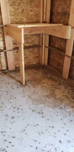

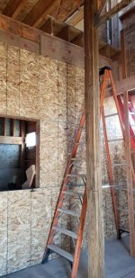

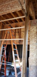

Went for a short bike ride this morning... about 5 miles. Not that far, but it at least got me out and moving. I'm already feeling a difference (for the better) in my knees.
Then, I worked on a few things at the barn/shop. Since it's been a while that I've worked on some of this, I spent a bit of time getting my head back into it.
The first thing I looked at was the lower landing for the loft stairs. Had to get a few measurements and stare at it for a few minutes to a.) remember where I left off and, b.) try to make sure what I'd done to this point was correct. I think this landing is OK.
Then, I added some blocking to begin building the upper landing and checked for level. The floor of the loft is 15' from the floor of the building. IIRC, the headroom clearance in the main shop is about 13' 10"... more than 12' to the underside of the open overhead doors.
Tomorrow, I'll set up the genny so I can cut some lumber and continue work on the landings.
Sent from my SM-N960U using The Garage Journal mobile app

I forgot to explain one thing in the 1st pic...
the debris on the floor.
Believe it or not, all those little dots on the floor... and piles along the walls and in the corners... are Miller Moths. There had to be tens of thousands of them. IIRC, 20+ years ago, we had an infestation of them in late spring/early summer. There were clouds of them. It was awful... anytime you'd go outside, primarily early morning or late evening, they were flying in your face... up your nose... whatever. And, you just couldn't keep them out of the house. At that time, the experts were saying that whenever conditions were exactly right, the swarms would occur. I've never seen that since... til now.
Apparently, this is good for the bears in the mountains on the west side of the state... guess the moths are one of their favorite foods.
Anyways. the ones in my shop are dead... I think I might have seen a couple of live ones as I was sweeping up. I'm glad I missed the party!

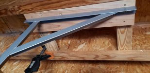

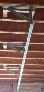

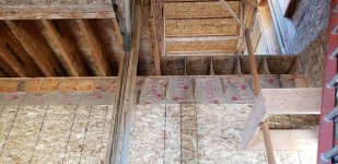

After I'd gone about as far as I wanted to on the landings, I returned to the garage door. Had a couple of things to finish up on the hangers.
I found these screws a few years ago and really like them. I rarely use lags any more... these are made in many sizes and are much stronger and easier to drive. A bit more expensive, but definitely worth it!
Thought I'd show a close up of how i installed the hangers. A couple of reasons i mounted them this way...
First, i didn't think it was a good idea to drive large screws through the flange of the "I" joists.
And mostly, I wanted to have blocking in place to make it easier to install the ceiling material when that time comes. ** note** I wont be installing the ceiling... i need to save some fun for the new owner!

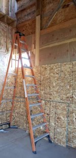

Then, it was time to work on the torsion springs. I already had the tube and springs in place above the door...
The first thing I did was to install the brackets on each end of the torque tube. This door uses a nylon centering bushing on one of the springs and I had forgotten to thread it onto the tube before I slid the springs on. So, I took the right side spring off, slipped the bushing on, and replaced the spring. Then, I installed that bracket. I must've been zone... forgot to get a pic.
Then it was time to install the center bracket. When I first looked at the center bracket, I was not impressed. I didn't measure it but I'm thinking it's stamped from 18 gauge... could be 16... at any rate, it seemed pretty flimsy considering the job it needs to do. So, I took some flat bar and machined a couple of relief cuts into it so it and the bracket would sit flat against the wall. I'm sure someone engineered the stamped bracket and that it would probably (possibly?) do the job but...
Bracket as it will be installed
And... bracket installed...
F
fourbyford
Aug 3, 2017
913
North Idaho... almost Canada!
There was a bit of trial and error but I finally got the center bracket installed at the correct height.
In this pic, you can see the centering bushing that will fit inside the hub of the L/H spring.
And, the springs joined... bolted through the bracket...
And, this part of the job done...
Reading and looking at the pics, it must seem that this was a 10 minute job... and, I wish it would've been... lol
Truth be known, I was up and down the 12' ladder at least 50 times... hmmm... maybe it was 150... lol... at least that's the way it feels tonight.

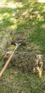

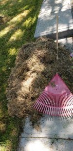

It's been a while since my last post. Lots going on. I've taken a bit of time to keep up with a few threads but have neglected my own. Time to catch up.
After being away for so long, there's always a lot to catch up around my house. My front yard was awful. When I had my dogs with me last fall, the older one insisted on squatting in the yard as soon as she got out the front door. I'll add that I have a tiny side yard out the back door, but she refused to do her doggie business out there. Who knows what goes through their minds... (with her, sometimes I think was very little... lol) Anyways, everywhere she squatted in the front yard, there was a small spot where the grass was dead. Her "favorite" spot was an area about 18" x 36"... grass completely dead. All that looked pretty bad. Combine that with the lawn that hadn't seen much water this season (but it had been mowed) and I'm surprised the neighbors hadn't complained.
So, it was time to do something about all that. I thought about starting the water tight away but, after looking at the lawn, decided I should rake/dethatch it first.
So, I retrieved the thatching rake and got to work. Good thing my front yard isn't all that big! About half-way through, my mind was on "power rakes" and why I hadn't rented one but, it literally would have taken longer to rent/return a rake (not to mention the expense) than it took to do my yard by hand. I was surprised at the pile I got from such a small area! But, it definitely looks better.
A number of years ago, my ex planted some flowers in one of the planting beds. She obviously had no idea what she was doing. First of all, for most of the growing season, they looked a lot like weeds... when they finally bloomed, the flowers were so small they were barely noticeable. And, they tended to spread like wild fire. By last fall, they had taken over most of the planting areas in the yard. I wanted to do something about them then, but was busy with other things. Then, some "vintage" roses had gotten a bit out of control...
After I soaked down a couple of the planting beds, the "flowers" pulled up pretty easily. There were lots of them! A couple of hours with the loppers and the roses were looking much better. Loaded the whole mess up and headed for the landfill/compost area.
Been watering the grass and it at least looks like someone lives here...
Still have a couple of planting beds to get to but I don't want to devote an entire day to them. Think I'll soak then down and work on them an hour or so a day... I'll get there eventually...

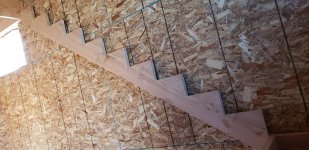

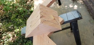

After the fun with the yard, I decided I'd better get going on stringers for my stairway. I'll have 3 separate runs of stairs connected by two landings. A total of 9 stringers and I wanted them to be as close to identical as possible. Over the years, I've seen some bad stairways... didn't want this to be one more.
I decided to make a template of the rise/run. I know they make the little gizmos that attach to a framing square but, I've used those before and wasn't all that impressed. So, off we go...
The first job was to lay out the shape on a scrap of plywood. Rise = 7.2" Run = 10"...
Then, I needed to align the cut on the tablesaw. I'll mention that I only raised the blade to this height to get the maximum width to reference my straight edge (framing square) and to make sure I was on the body of the blade... not the carbide. The power to the machine was off... I lowered the blade to the correct height (very slightly above the surface of the plywood) before cutting.
And, despite my best efforts (and not wanting to make a career of cutting out a simple template) the 90° angle was the slightest bit off. Time to break out the edge sander for a tune up.
After a bit of tuning on each edge. I finally achieved a 90° angle... but then, my original layout was off a bit. No worries.
Then, I needed to attach a "fence" to the edge of the template...
Fences attached to both sides and trimmed
Now that I have a template, its time to make a bigger template...
F
fourbyford
Aug 3, 2017
913
The small template made laying out the longer template a breeze...
I had a strip of plywood left over from the soffit on the barn... perfect for this job. I ripped it to width, making sure I had straight and parallel edges. Because the edges were straight and smooth, it was easy to accurately align the small template.
Time to cut!
The base of my circ saw is stamped that it is 1 1/2" from the edge of the base to the blade. Nice theory but not very accurate. And. I should mention that this dimension will change depending on the thickness of the blade being used. So, I made a couple of gages that will accurately space an edge guide... depending on which side of the line I want to cut from... blade left (of the line) or blade right...
It probably seems I'm getting a bit carried away... if I were to be off a bit, its only wood... right?
What I don't want to do is compound a lot of error... over 22 steps, that can add up...
And, I'm making a template to be used on 9 stringers. I want it to be as accurate as I can make it.
Edge guide in place... ready to make the cut.
I think this is gonna work!

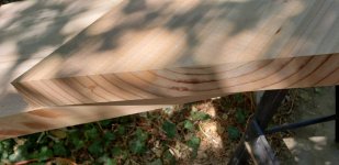

Now that I had a good template, it was time to cut some stringers.
The last few times I used my tablesaw, I noticed it took a bit of effort to push the wood through... and noticed the slightest bit of burning in the hard areas...
Time for a new blade!
I've had this saw for about 25 years... it's literally cut miles of wood.
For the most part, the only blade I've used on it is the Freud 50 tooth combination blade. I've tried other blades... none of them come close to the performance of Freud blades.
About the time I was working on my saw, I was trying to keep up with BD Becker's thread, The **** Shack, and his story about resurrecting his new (to him) tablesaw. In post #738, he made the mistake of asking if anyone had any recommendations for a good saw blade. A spirited discussion ensued. I relayed, in detail, (can you believe it??) why I'm convinced Freud blades (or any of their cutters) are arguably the best money can buy. I won't repeat all that here... if you're interested, head over to BD's thread and check it out!
At any rate, the reason I needed to change out my saw blade was to true up the edges of the lumber I'm using for my stringers. I actually found some pretty nice boards but, they needed a bit of help. I first cut them to rough length, then ran one edge through my jointer. Then, to the tablesaw to rip to finished width. These are 2 x 12's...
Once I had the lumber cut, it was time for layout...
And cutting the stringers...
On this first one, I forgot to cut the thickness of the tread from the bottom of the first step... something easily fixed.
I cut the stringers using the gage/edge guide method I'd used when cutting the template. The cuts for the risers went pretty well... they were at an angle not too far from being a cross cut. The cuts for the treads... not so much. Their orientation was closer to a rip. I noticed that I was getting a great deal of deflection from the thin-kerf blade I've been using in my circ saw. Fortunately, the bad part of the cut was on the waste side.
This pic is from a different cut (a 45° bevel cut) but with the same result.
So, I set out to find a 7 1/4" full-kerf blade for my circ saw...
How hard can this be... right??
In my research, I found forums with others complaining about the same problem and searching for blades. I looked a couple places in town and even called the place I formerly worked. No Bueno. It seems the only blades readily available are the thin-kerf variety... approximately .059"... too thin! After more digging in the forums, I found a site with a limited selection of full-kerf blades...
I'm not familiar with this company but I'm gonna give it a try.
As I was cutting out my stringers with the thin kerf, I found a work-around... raise the depth of cut... start with a shallow pass and work down to final depth in 3 passes...
I'm not going through that on the remaining cuts... not to mention that I have to make more bevel cuts which also require 3 passes to complete... a bit unnerving. I ain't goin' there! Ordering a blade today!

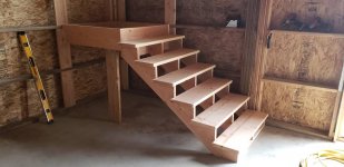

Even though it was a PITA, I was happy with the accuracy I was able to achieve while cutting out the stringers.
These are drops from cutting out the steps. They are virtually identical in size...
As a result, the stringers came out virtually identical as well...
And, it's beginning to look like a stairway...
When I head out today, I'll be working on the upper landing. Hopefully, my new saw blade will arrive by the time I need it!

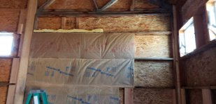

Well, I mis-spoke when I mentioned the name of the insulation... it's Eco Touch. Looks like I came up with the wrong environmentally friendly name. Whatever... I put up a lot more of the stuff yesterday and it still made me itch.
When I built this, I placed the girts on 24" centers. Of course, the bay at the top of this wall ended up being 16" (because of the way the mono-truss sits in the wall)... a bit over an inch wider than the insulation for 16" centers. I didn't want to cut down the wider stuff, so I found a scrap of the old-school insulation (the mega-itch variety) and cut a couple of strips... placed them on the girt... then placed the Eco insulation. I cut the vapor barrier into 6" wide strips and pieced it in. Not perfect, but it will definitely work... especially once the OSB is pressing against it.
The blocking in this next pic is there because I needed to provide support to the "bookshelf" girts to carry the load of the landing. This made for a fun time. I thought about cutting the insulation into two pieces... that would've made it much easier to get the insulation behind the blocking. But then there would be a seam (break) in the insulation that really didn't have to be there. How hard could this be... stuffing a bit of insulation behind the blocking? As it turned out... plenty difficult! Not only was I trying to stuff the proverbial 10# into a 5# opening, in two of the bays, I had to be mindful of the needle-sharp screws that hold the siding on. They stick into the bay about 1 1/2" and the screws are spaced every 9"... plenty of opportunity for a nasty cut.
Anyways, I managed to get the insulation shoved into place and managed to avoid injury. But, I couldn't have gotten any more fiberglass on me if I'd cut a chunk of this **** off and used it for a loofah in the shower. I'm still itching this morning. Dunno... maybe that's what woke me up at 3:00. Oh well... its all good. I still have more insulation to put up but, at least the wrestling match is over.
After the insulation ordeal, I managed to get 6 sheets of OSB hung. I'll need to install a bit more blocking today, then hang another couple of sheets of OSB... then I'll be able to reassemble the lower landing and finally make more progress on the upper.
This entry area is roughly 16' square and my mission has evolved into getting it "finished out"... at least with OSB. I realize there is no wiring in the walls but, it won't be that big of a deal for someone to remove a few sheets of OSB... or, there's always surface mount...
That'll be for the new owner to decide.
...D

After getting the first few sheets up, which took me to the 8' level, it was time to break out the big ladders.
Maybe 10 days ago, there was a thread on General Garage Discussion where someone asked for advice on how to hang sheets of OSB above the 8' level. That discussion was interesting to say the least. Everything from using sheet rock lifts... to renting a man lift... to rigging a pulley (block and tackle?) from the trusses... All that is OK... I guess... we all have our own ways of doing things...
I prefer to just grab a sheet and carry it up a ladder. And... I've been working alone for so many years, I wouldn't know what to do with help....lol...
First of all... it helps to have good ladders...
This one is a 12 footer...
I sort of "cheated" on a couple of these sheets... I tightened a "C" clamp on them and then just carried them up the ladder like a suitcase.
It can get a bit dicey once you're trying to maneuver the sheet into place... but, its all good...
Depending on how things are going, I might start a screw in the sheet before I carry it up... i always shove the driver in my back pocket so its handy when I need it...
Step and repeat...
Still trying to figure out why this takes so long... lol

A while back, I mentioned having an issue with the thin kerf saw blades...
The blades I ordered from California Carbide arrived in good time... especially considering they shipped from the east coast. The customer service of both companies... C. Carbide and FS Tool has been nothing short of outstanding! If you're ever in need of carbide tooling, it might be worth a phone call...
Anyways, I got the blades and installed one on my Porter Cable circular saw. To cut to the chase... my blade deflection issues are GONE!
So... a bit of discussion...
Several years ago, I built a fairly large addition to my house in Utah... part of the roof on that addition required 2 x 12's for rafters. At the time, I was using my Makita hypoid saw... was hogging through the cuts on that 2x material pretty much as fast as I could shove the saw through the lumber. And, in the years since, I still tend to be fairly aggressive when cutting dimensional lumber. Thinking about it, I guess I developed a bit of a bad habit and got a bit complacent concerning the process. Another issue is that, more recently, I've been using some sort of a "guide" for pretty much every cut I make. For cross cuts, I just use a Speed Square to guide the saw... I find i can get cuts nearly as accurate as a miter saw in half the time. If I'm ripping plywood, I set up a straight edge. Even though it can take a few minutes for set-up, having parts that fit snugly seems worth the effort.
So... I've finally realized that the blade deflection occurs when I'm using a straight edge to guide my saw. The cross cuts are generally not a problem... but, ripping will cause the blade to deflect every time. I experienced the same issue when trying to make a 45° bevel cut... even though it was a cross cut. Years ago, when I was using my Makita saw, I don't remember having any issues but... thin kerf blades weren't the norm at that time. Today's thin kerf blades definitely have value... they produce very nice cuts... produce very little sawdust... require less power (cordless tools??)... but, when used outside their design parameters, can have drawbacks.
These full kerf blades seem "massive". They're heavy... i noticed a bit of a "gyroscope" effect when I first powered up my saw. Definitely something to be aware of...
And, as I mentioned, I think its pretty easy to get a bit complacent when using power tools. I think the thin kerf blades provide such a nice cut, in part, because they're somewhat "forgiving"... meaning pretty easy to use... (on a crosscut) they'll follow a line...
The full kerf blade, on the other hand, will CUT where ever you guide the saw. My first couple of attempts at a free hand cross cut were pretty pathetic... lol. I've been relearning how to use my Porter Cable saw. Guess I should break out the Makita... might be easier...
Anyways, the blade produces a great cut (although not quite as smooth as the blade on my UniSaw... hmmm... why would it??) and has completely eliminated the issues of blade deflection.
I don't have my measuring tools here do I won't be getting into the technical details but, it's easy to see that the blades are well made. And, when one gets dull, it'll definitely be worth sending it out to be sharpened.
Hope this info is of some value...

I've been continuing to work on getting the OSB finished up in the entry area. As of my last post on the subject, I had pretty much gotten the "easy" sheets hung and maybe half of of the insulation.
The stairway has evolved a bit from what I had first planned. I originally thought the stairs would sort of "double back" on themselves... going up a few steps to a landing and then turning back 180° to go the rest of the way to the loft. Due to headroom clearance issues and windows that I hadn't originally planned, the stairway changed to where it is going now. I had originally built a wall coming down from the ceiling to help close off the stairway from the rest of the building. With the changes, that wall is no longer needed...
So... it goes away...
Then it was time for more insulation...
I also continued work on the west wall. Insulation in... a bit of a challenge getting the sheet above the window and landing...
I'm pretty sure I'm getting too old for this... hahaha...

In this pic, you can see the area the where the sub-floor was removed...
Finally! The last of the OSB for the entryway...
The sheet above the landing on this wall was, without a doubt, the most difficult sheet I've had to hang. I needed to get it up 12', then "laid over" the landing... while missing the tail of the floor joist to my left. Looking at it, it didn't seem to bad... actually getting it in place was a bee-yotch...20200818_141254.jpg
The final half-sheet above the doorway was a piece of cake...
Glad to have all that behind me. I still need to drive about a half box of screws to finish but that shouldn't take too long.
The reason for the diversion onto getting the OSB up... is because once I get the stairway in place, there would've been absolutely no way to reach any of it with a ladder.
Now, once I finish the stairs, this part of the project is DONE!!!

I crosscut the pieces... jointed the faces flat and ran them through the planer. So far, so good. I decided to use "half lap" joinery... easy to do on the table saw.
I briefly considered setting up the stack-dado set... but figured I could have the joints nibbled away in about the same time it would take to set up the dado. It ended up taking me about an hour to cut all the joinery. As it turns out, the dado would've made sense. Oh well... got it done...
As you can see in the pics, turning that much wood into sawdust makes a pretty sizeable mess. No worries... the janitor will get it...
So, with the frame glued and clamped, time to look at the hardware. I had a quantity of 3/8"-16 bolts... just what the doctor ordered. Except that the casters had little "flats" in the fastner holes limiting fastners to 5/16". A quick search revealed I had no such hardware. So, round file time. Actually, it didn't take a lot if time to open up the holes and I was waiting for the glue to dry anyways...
Not sure if anyone uses round files much... I've found that files sold for sharpening chainsaws are inexpensive and are actually very good files. They cut fast.
So then, it was time to cut a rabbet for the plywood. Found my router right away! It even had a 3/4" mortising bit in it. Hmmm... whoever used this set-up the last time certainly got their money's worth out of it...
The bit looked dull... virtually all of my router bits are at the Idaho shop and I refused to make a trip to the store for a new bit. Besides, how bad could this one be?? Answer... pretty bad. Had to make the 5/8" depth of cut in 3 passes... abd that was pushing it. Again... I managed to get it done... amid clouds of blue-black smoke... cough cough...
Finally, it was time to locate, counter bore some holes, and install the casters. The 2 ridgid casters worked fine... although the heads of the bolts pulled through the counter bores a bit more than I expected. Oh well... it would work. As I went to install the two swivel casters, I realized the bolts I have are too long... won't allow the swiveling action. I briefly considered the hacksaw/file approach... then got into my truck and headed to the farm store. Some correct length bolts and flat washers later and all is well.
So, it was anything but quick but, I'm pretty sure it will do what I need it to...

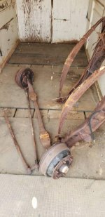

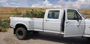

Today's project involved breaking down the front portion of a truck frame...
A while back, I was talking to a friend. I told him I wanted to build a farm wagon to use behind my draft horses and was looking for an old straight axle front end. This guy knows just about every "car guy" in town... I figured he could scare something up.
A few days later, he called me and said he'd found something even better than an axle... he had an entire truck. I told him I really didn't need a whole truck... just the axles would be good. A few more days later, he called and asked where I wanted "it"? I ended up with a frame from a late 50's Studebaker 1 ton (I think... everything is pretty "heavy") minus the cab, bed, engine and trans.
Thinking back, I should have taken the whole truck...
Anyways, I had used the gas-axe and cut up most of the frame... the rear axle is already at the Idaho shop. For reasons unknown to me... I had never gotten around to dismantling the front end. And... it was in the Cowboy Moving Van (known by some as a horse trailer) taking up a metric ton of room. Thus... today's mission...
Here she is in all her glory. What could possibly go wrong?
Actually, most of the fastners gave it up with only a bit of a fight. The bolts holding the axle in place... not so much. I had brought what I thought was enough tools with me. The socket set had a 1/2" drive ratchet that has worked for a lot... but didn't have enough leverage for this job. I went to grab the B.F. breaker bar that I was SURE to throw in the truck... no bueno. Let me just say that getting older *****... and... the mind is a terrible thing. So, back to town... grab the breaker bar... and a set of deep sockets... and back to it. Out of the 8 nuts (on the "U" bolts holding the axle to the springs) 4 twisted clean off. As it turned out, those were the easy ones. The other 4 actually threaded off without breaking anything... except possibly my shoulder... lol
So, all the bolts loose/removed and a couple of whacks with a hammer...
Taking up much less room now...
Pretty sure I'll leave the frame behind. Will take it to recycling after I cut off a few parts. I want the spring and shock mounts and the cross member. Got a couple of projects bouncing around in my head.
Something like this is what I had in mind to build. Now that I own this one... I may or may not build the one I was planning... probably will. Or... the front axle might end up on something with a few more "ponies" under the hood...
Time will tell...
