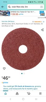

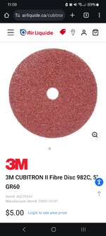

They are fibre sanding discs. Used basically anywhere you would use a regular flapwheel, maybe not as good on inside corners etc.
Usually gettem in 25 or 50pks. Ends up being a fraction of the cost of running flap wheels and they last pretty damn good.
Mounts on one of these on your angle grinder in whatever size you like.
I use them occasionally on air tools. There’s a stack somewhere in the shop but they’re not a go to disc for me. My stock is probably twenty years old. I don’t think the air ”grinder” even came with a guard.

Seems crazy to me. Looks like a lawsuit waiting.
What about a 3" roloc ScotchBrite disc or they also make fibre discs on a right angle die grinder, also need a guard?
You could make one yourself I guess but youll limit the usefulness of the tool by using a guard.
