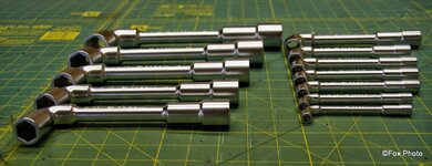

Very common in Europe, especially France, where it's called a clé à pipe, or "pipe key". We have a longish thread on them in vintage tools -- one started by @Private Lugnutz, I believe.
They're definitely not a gimmick. We used to use socket wrenches (their name here) in the US in the first third or so of the 20th C, but they're out of favor these days. They're available forged (like your illustration) and stamped for lower price versions. One can get clés à pipe with 6-point/6-point and 6-point/12 point.
I use mine all the time. They're quite convenient once one gets used to them.

With respect to clé à pipe vs a breaker bar and removable socket, here's my logic...
Much of the work around my home garage is on my two Toyota Tacomas or my Lexus RX350. Given that almost every nut and bolt on a Toyota will be 10, 12, or 14 mm, it's super-easy to have those three clés right at hand. One doesn't need the full range of a socket set, and the convenience and efficiency of the pipe keys works very well.
The built-in extension of the long arm, using a screwdriver as a T-bar, gives a lot of versatility. Here's one of the images in the thread Lugz linked above that shows how this works, as well as the pass-through noted above by @dnschmidt.

You missed one. You can also put a round bar into the recess in the longer section and make it as long as needed. I had my friend machine some tool steel bars that exactly fit the blind socket end and as Archimedes said: give me a long enough lever and I can move the world. Let me tell you about the French as I worked besides them for 15 years. As a German I'm suppose to hate them but I surely don't. Yes, they are arrogant pricks at times but they are far better educated that the typical American and they work hard when they do work which is when they aren't on vacation which is about two months out of the year. (Good for them!) When they are at work they actually do work and don't **** off and pretend to work as we Americans often do. I respect the French even though that tech thought I was a stupid American for not knowing what a "wrench" was.

Yes, that can definitely work. It's pretty common in France to put the clé two sizes larger on the back end of a smaller wrench to give more leverage. Sorta like how two combination wrenches can be used together. Pipe keys/socket wrenches are nearly indestructible, though, and that kind of "abuse" doesn't seem to hurt them at all.

That’s the original French version of a box wrench.
That style of wrench has been made in France since at least the 1930s.
The long end can be used similar to an old fashioned( but still occasionally manufactured) tubular Box wrench.
the bent end is made to be used similar to a modern box wrench.
The opening thru the bent end allows you to put a metal rod thru if you need to apply more leverage when using the long end socket for turning tight or stuck bolts/nuts.
The long end has a round profile due to the socket on the end, which makes it perfect for cheater pipes if you need more leverage when using the bent end.
The profile of the wrenches is round, which makes them more comfortable to use than the common “knife-edge” you find on a lot of wrenches nowadays.
Facom, and SAM Outillage, were the two major French manufacturers, although there were others such as MoB Outillage, and even Stanley sells them in France.
Beta tools from Italy seems to offer nice ones.
A bunch of Asian manufacturers also seem to make the style.
If you look at the design of the wrenches, they seem to be forged similar to a typical forged socket, were both sockets are forged into the ends at the same time.
I’m not sure that the wrenches even get or need a separate broaching operation after forging.
A groove is then milled in one end thru the socket, and that is heated and bent to the correct angle.
I presume the point of the design was that equipment set up to forge sockets could be used to manufacture these wrenches, and costs are saved making broaching cutters, and having to run broaching dies thru both sides like on a normal box wrench.

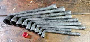

To me they look rather indisputably like antique American offset socket wrenches, when sockets were fixed to the ends of shanks, either forged, press-fit or welded, made by the likes of Walden, Mossberg, and Blackhawk. And, in the case of some mfgrs, such as Braunsdorf-Mueller and Vlchek, who actually made them from tubular pressed steel, they are almost identical kissin' cousins.
Here's a c. 1918 set.

Thanks for bumping this @mvcorse. I've expanded my set of oldies (all made by Braunsdorf-Mueller in NJ, USA, c. 1918) with a recent flea market find and can now cover 3/8" - 1".
