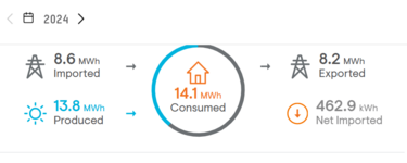

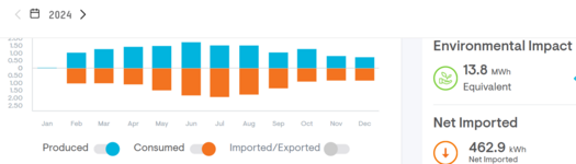

Not sure if this will help, but I'll throw out some numbers for my home. We installed 39 panels beginning of last year, nominal rating of 15.6kw. 2200 sq ft house, no outbuildings. I'm in SE VA, so climate wise it may not be that far off your location in Oregon. Summers get in the 90's, winters are moderate, down in the 30's to 40s but some days colder or warmer. We cool with electric but heat with gas as well as hot water and the stove and dryer. For the 2024 year (11 months, system installed in Feb) this is what we got:
So we are pretty balanced on the electrical side. We use most gas during the cold months which is not reflected here. VA is a 1:1 net metering state and any excess is credited to future billing cycles where you may fall short. Don't forget to factor in SREC's as part of the payback cycle, though that varies quite a bit by state. I get about 40 a credit, my brother in NJ gets around 100.
Since you are dealing with larger areas and all heat/cooling electric, you would probably want to scale accordingly. One thing I don't have visibility on is how much sun your roof/property gets. If you have an ideal southern exposure, then your results will be better.
