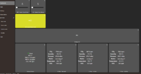

I've updated the automation to include 6 balanced CFM profiles, from 50 to 110 CFM. Previously I could only get to 90 CFM due to the 4" wall hoods.
There are now air quality sensors on each floor. Ventilation rates are set by average CO2 across all the sensors, but high radon levels, or high VOC levels will overide the C02 settings. If the kitchen exhaust fan (again, inline EC) fires up with the induction cook top, then the HRV goes into "make up air mode" to deliver about 100 CFM, offsetting the kitchen exhaust. I've also added a bit of code so that the kitchen exhaust fan itself changes speed based on power use by the induction cook top. This works quite well and keeps the kitchen exhaust fan at the lowest/quietest setting, ramping up as more pots/higher power levels are in use.
Below are the air quality sensors controlling everything:

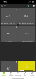

Can you talk a bit about the heating power of the HRV vs tempering heat? you mentioned it in another thread that I didn't want to derail.
D
Denwood
Sep 22, 2014
4,224
Thunder Bay, Ontario, Canada
Sure. If you look at this pic, you can see that 29.3 F air has been heated to 60.8 F …and this is before it hits the PTC inline heaters to bring the air closer to the target set at 65 F. The system is calling for fairly low air exchange right now at 50 CFM. So 50 CFM heated 30 F works out to 499 watts of heat provided by the outgoing air’s heat energy, exchanged in the core. The sweet spot seems to happen around 75 CFM with outside temps just below freezing…recovered heat jumps up to 650 watts or so.
The automation system dials up power to the two PTC heaters based on an equation that takes the current CFM and temp difference into account and spits out a dimmer setting. I measured actual power use by the heaters at different dimmer switch settings to figure out that equation To take the 60.8 F air at 50 CFM and bring it up to ~65 F requires about 77 watts, and the system is showing a calculated 82 watts…pretty close. The two heaters are pretty close to 100% efficient, so we can calculate the power being used pretty accurately.

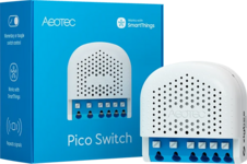

A little tech stuff here. I wanted to add power monitoring for my HVAC system, so installed one of these Aeotec Pico relays in a junction box that feeds the system.
This unit is pretty tiny ( 44 x 40 x 21.5mm ) and would easily fit behind any standard light switch. This allows a "dumb" switch to be connected, but also override that switch with automation. You can use these to switch up to 15 amps in NA. The Pico switch also reports power, and allows me to reset the HVAC system remotely as well if needed. This is my Hubitat dashboard that monitors the system. Having power monitoring is quite handy as I also have two PTC heaters that are dialed in to deliver tempered fresh air. The heaters are on, and you can see at 50 CFM total power use with the two ECM fans, HRV damper control, and two PTC heaters totals 50 watts right now. With the heaters off, and CFM at 110 CFM, total power use is only 82 watts. Kind of crazy considering the HRV when using the old fan motor (now removed) used over 300 watts to move 90 CFM.
All of this came about when I realized in testing a few days ago that one of the PTC heaters has failed. It's pulling wattage, but not heating anything. If anyone knows much about PTC heaters...all ears on this one! Temps are just getting down close to freezing at night so the heaters are just now coming into play for the winter season :-( I'm using two of these 500 watt heaters in a metal housing placed inline to the fresh air delivery duct. Cost is all of $25 per unit.
