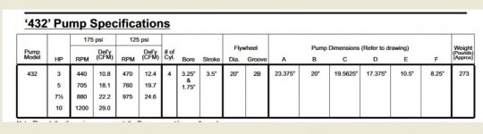

I got my old Weaver 432 compressor ( 1962 year ) going and plumbed it to a 60 gallon tank. It works great but over the years people have messed with the pressure regulator valve setting.
. I have it set at 120 psi to cut out and it works. Not sure what pressure it should kick back on ? It is now cutting back on at 40 psi which I think is low. There are two adjustments under the cover I made the red mark on. One is larger than the other so assume that is cut off setting and the smaller one is cut back on ?
Can anyone recommend a regulator to install on this ? To be honest its never had a regulator since 1962.
My compressor is being run by the original 5 hp 3-phase motor. It is old like me and I want to make sure it out lives me :)
Any suggestions welcomed.
I have three new 90 inch belts installed now. Not sure how tight they should be ? I was reading tonight here about over tightening the belts.

If it cuts off at 120, I would have the compressor come on around 100 psi, 40 is definitely too low. For belt tension, my compressor specs 1/2 inch deflection when a 5 pound force is applied to the middle of the belt. So use common sense, tight enough so the belts don't slip, but not so tight as to cause stress to any bearings.

This is 2 stage, on at 120/130, off at 175. This allows tools like 1/2 impact to deliver 90 thru 50 ft of 3/8 hose and reel at any point in its cycle. Set regulator just above its kick on.

Even if the tank is only rated at 150 psi ?
Also do you know which one of these adjustments set what ? I read where the larger one sets cut in when pressure is low. I always though the larger one was the one you adjust to cut off compressor when air pressure is achieved ??

That tank should be rated at 200psi like almost all tanks are. Find the tag on the tank that has been welded on and has the info stamped on it. Tighten the taller adjustment to raise cut out pressure and tighten the shorter one down to close up the gap in cut out and cut in pressure. I would close up the gap before raising the cut out pressure first if it was mine and if it won’t close up the gap then replace the switch.

This is not the original tank. It is stamped on the side> rated 150 psi , I almost sure. I will look again tomorrow. My original 80 gallon horizontal was rated at 200 or maybe a little higher.
I also installed a new 150 psi Safety Valve.
I am not running but a few things in this shop that use air and its only me here so lower pressure like 120 psi would be fine unless I need to set it higher ?? I do have a 50 foot reel hose ( 3/8th ) that I use. I don't want to plumb air to this shop at my age. I just need air on occasion.
I just wanted to get this old 432 compressor back running and I did. I know this compressor is a overkill for what I do but it is here and with a little work I got it back going. It was already wired for 3-phase and the motor runs great now.
I just want to make sure I have things set right so I don't trash this thing. I do remember many years ago the heaters went bad but I had leaks back then under the slab and the compressor was running a lot. The setting were probably wrong. :(
I was young back then and didn't pay attention to things because I had to make a living working here. Not anymore. Just a hobby for me now. :)
I also had this 60 gallon tank that was give to me in perfect condition so why not use it.

If you installed a 150psi safety valve then like other have said I would just set it’s cut out at 140 and cut in at 100 and you should be good to go. I currently have my 1963 Quincy setting at 145 off 110 on and I also use a 50ft hose and hose reel and have two more 50ft hoses to add to it when I have to reach farther away and I’ve not had any problems at all. It’s fun getting the old compressors up and going and giving them a new life

Here is the one on it now. As you can see it cuts off at 175 and back on at 140. My tank has a data plate on it saying 150psi

If your tank is only rated at 150 then this one would put you at 135 off and 105 on and keep you under the 150 limit

155 is way better. The purpose here is to store energy. Along with a regulator it gives way more headroom and steady supply. At 135 could skip a regulator but on any heavier tools it will start to fall below its performance threshold about 1/2 way down the cycle. It may not matter but it all kind of defeats the purpose of having a good compressor.

Yes it will work. You can get the 155psi one and adjust it down if you want too. Their the same switch’s but just set differently. They put hot glue in the Phillips adjustment screw to keep ppl from adjusting them but the glue is easily removed to lower the psi to suit your tank pressure

TonyJ, I really appreciate the tips on this compressor. I got the part today that you suggested I order. I wired it white wire to line and black hot wire to load. This thing works perfect. I cannot believe how fast this old compressor builds air. No leaks at all. Kicks back on at exactly 105 psi.
This part does look cheap but it is working and no more than I will use the air compressor it will probably out live me

That Weaver is probably a DeVilbiss 432. Never heard if Weaver but that i.d. tag is a perfect knockoff and the crankcase around it looks identical.
