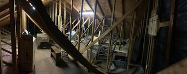

Hi everyone! Long time lurker, first time signer upper and post-er!
Quick backstory; I Bought this place after selling my first during the real estate boom here in Washington state. After a while here I discovered my “safe space” aka the shop (lol) had been afflicted with what appeared to be termites. Turns out they were carpenter ants. They did a number on the framing.
Which leads me to my question- is jacking up the rafters in front of the header going to be enough to support it while I remove the header? Also will likely need to replace some of the top sill(sp?). Looks like these little pos’s made it through at least one of the 2 2x6’s comprising the top sill. The span of this particular shop bay is approx 10’ 1”. The header is a 4x12 with 2x4s to be flush with the interior wall.
I’ve attached pictures to help paint the picture.
Thank you all in advance

Yes, you can just get some screw jacks or wood jacks under the rafters on the inside and change out what you need to in the framing below. Personally, I’d cut the drywall back, string a 2x6 across the area I was lifting, and place a jack every 4ft, at least. This will keep everything nice and straight.
You don’t need to lift it but 1/16th. Basically just take the weight off and give enough space to sneak everything back in there.

The rafters in my shop run parallel to the garage door. (top sill). How would I go about securing the 2x6, would I run the jacked 2x6 perpendicular to the rafters?

Thinking about it some more…
If you are ok with taking a few of the exterior slats off the wall, I would do that above the top plate, including 16+ inches beyond the garage door to each side. Then, scab a 3x8 onto that open area, using 2 ledger screws into each stud, and use 2x4s to support it along its length. I would run a temporary “bottom sill” on the ground to nail the 2x4s into. I’d probably run a few heavy nails from the 2x4 into the asphalt, especially if it is sloped.
The 2x4s would have the wide face against the wall so that they can support the 3x8 from underneath it.
The ledger screws need to stay at least 1” away from the top/bottom edges of the 3x8, and I think 5” away from the end of a stud they are screwed into. So make sure it is up high enough above the top plate.
Once this is setup you will have free and clear access to the whole interior and be able to change whatever you want. Review this option for yourself if you think it is safe, and hire it out to a licensed framer if you are unsure.
Consider whether you want a wider garage door at this point because it’s not much additional work.

Seems like 3x8’s can only be acquired from an actual lumber yard. Can I use like a 6x6 instead to split the difference?
Since you are stripping the exterior, you could use a 2x8. Again, use ledger screws into each of the studs above the top plate to support the weight of the eves.
Notch a 1.5x7.5” section out of the top end of the temporary 2x4 supports, so the 2x8 is supported by these notches. Put a couple GRK style screws through the notched upright of the support stud and into the ledger to lock the supports to the ledger. The temp studs will have the narrow face against the wall in this case. Have a nail plate at the bottom, below the temp support studs.
I’m picturing the support studs every 16-24”.
I’m suggesting an 8x lumber to keep the 2 ledger screws from splitting the existing studs in the wall. It will give them a little distance between each other.

Wow! Talk about overkill.
You said the roof is stick built (rafters). So the greatest load point is the ridge support that comes down to the garage door header- which is offset.
I would just temp-support the ridge. Have the new header on-hand and ready to install. Pull out the damaged header, and install new- that opening isn’t going move when the old header comes out.
I also would not use solid dimension lumber for a new header- it’s not as strong as a build-up header of multiple 2X lumber. Or, use a LVL (that’s what I would spec/do). Also, the header should go to the top plate(s), then cripple down. Header down, cripple up- like you have presently- generally lends itself to a wavy top plate.

I know this is a little carriage-before-the-horse-ish, but I’ve been wondering about putting an apartment up above the shop. I’m out here all the time and I figure I could rent the house out and just set up home base out here.
What do you think. Here’s some photos. I’m 5’10” or so and I took a selfie to giver some scale
It’s HUGE up there. But there are the roof trusses. Have you ever done a conversion like this? I noticed they didn’t even put the sheathing all the way up and I was thinking how easy it’d be to start framing for it this summer.378A91EE-0081-4B9E-9417-2D8169D37C83.jpegF1819354-4BC9-477F-B4FF-B177425BF8CA.jpeg

I doubt there is an easy way to convert that to an apartment. Best case you have an engineer design custom trusses and you find a way to sneak them in there.
You would be better off ripping the everything off and starting over with different trusses or building a second story altogether. It’s a shame because that really is a lot of room. But new trusses could have more vertical lift at the wall, and have floor joists worked into the plan.

Just so you know- that’s a truss roof system- not rafters. So there’s no ridge. Also, the end trusses are usually a little beefier- and because of the the way that end is built- it’s basically self-supporting. You didn’t really need any temp support at all.
The upper part has no sheeting- so if you rip off the siding, which is the plan, you could probably get the new trusses in between the studs.
So you think that that the roof would essentially need to come off and be redone to accommodate an apartment? Doing something like that I’d hire out to do the structural beefing, but then I’d do everything else myself piecemeal.

Quick question- so I picked up a Doug fir 4x12. Eric was right, was going to be a special order for gluelam and time is of the essence, as they say.
Since this huge beast is going to be probably too much for my bro and I to muscle up there, can I use a chain hoist attached to one of the trusses above? Perhaps a 2x6 going across 2 of them to share the load ?
Also, I heard mention of “top and bottom” orientation for headers. There are no such markings that I saw on this 4x12. Is that for gluelam only? I don’t want to EFF this up.
Thanks you guys, much appreciated.

Yes, crown up. Cup your hand a little hand point your palm to the ground - that's how the beam should be installed. :)
