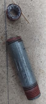

I didn't really get before pictures but the pressure relief valve was broken on , as well as the ****** from the tank to the pressure switch.
Pulled the broken ****** out of the bung with a pipe ****** extractor . replaced the ****** with one on hand ,
cut the broken threads off of the pressure switch and tapped the threads deeper so a 1/4 npt would thread back in.
reassembled it all , sans the PRV . Not sure where I laid it down. but I do have others in my hoard if needed. so basically this was a zero dollar repair.

What kind of pipe ****** extractor did you use? I don't have one but need one.

The largest EZ-Out that will possibly fit in the broken ****** is what I use. I prefer the straight-fluted, but you're getting into the hard-to-break sizes at 1/2".
Use some heat before trying to back it out. The sealants that are used soften up nicely a little above the boiling point of water. A good heat gun will work fine.

I have several sets of EZ outs, an Irwin spiral type set and a set of Mayhew wedge type and none of them have a size that wants to work for that diameter of broke off pipe. Closest ones I have are too small to bite or too big to fit. When I brought it home I figured I'd have it out in a few minutes but it put up a good fight, like it's glued in. I dug a little groove with a small diamond file to give me something to tap at with a punch to try to spin it out and that sure aint working either.
I looked up a set of pipe ****** extractors and see a couple different styles, though most look to be for larger pipe than what I'm dealing with. Unless someone has experience using something better I see there's a Husky set I might pick up at HD later today when I go that way.
A 1/4" pipe ****** is what I picked up to replace it.

The spiral-flute is labeled M No.5. The straight-flute, I can find no markings upon it. Both are 0.44" across the shaft. 1/4" NPT ****** for reference.
I had to hammer the bit into the broken ******, quite hard actually. I ended up using a small sledge hammer to drive it it . then it took quite a bit of force to get it moving. I did use heat too around the bung to try to expand it a wee bit. your break looks just like mine did.
edit. I realized after the fact that the ****** was schedule 80 pipe , thus the force needed to get the extractor fitted . had I realized i would have drilled the ID of the pipe .
I realized today that the ****** is schedule 80 pipe, that's why the extractor was hard getting started .
I also discovered that the piston ring & cylinder is badly worn & wont build over about 50 PSI . so now I guess I'm looking at repurposing the tank... although aftermarket rings & cylinders are available for not a lot of money . :unsure:

That's why we used to refer to the oil-less compressors as "airless" compressors. The bottom of the piston is open to the environment, so dust and dirt and **** gets sucked up into the bottom of the cylinder with every stroke. Maybe fine in a shop, but death to the comp on a jobsite.
Wish I had a set like that when doing my dip tube on my water heater. Ended up using a hack saw blade inside and cut the damaged ****** end out. Then had to chase it to clean up the thread to reinstall dip tube.
NHtoolguy
Mar 4, 2018
350
Gilford, NH
I have had good success with an internal pipe wrench for broken *******. They have an eccentric cam that grabs tighter as more torque is applied. And, they don't shave material like an extractor tends to do.
