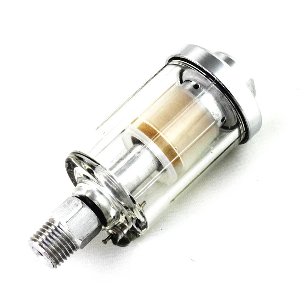

I have added an Air/Water Separator, to the end of the hose, too.
http://www.amazon.com/gp/product/B002GQ3SUA/?tag=atomicindus08-20
