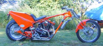

Thanks again all, as we all learn something every damn day. Its the cool rainy season PNW, and simple bored. Soon? Shop door open, bikes out, as one my 3 boats and forget all about it..(until next winter!) Pic my shop, and a 15 foot I rigged up, crank up rebuild Merc (some say overpowered? BS! To MUCH aint enough:D) But some my toys first.
Leave ya with this. When I hear "electricity isn't rocket science"? BS! Do it wrong and .."rocket ya on yer *** FAST" "stick a fork in here and...(tasers are kids stuff compared 220/50)! Pix some my junk. Thanks again all;)
The boat build next..thats the frame up Dragbike I built 25 years ago, still sitting here but pickled.
