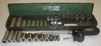

Hey guys.....
We've got Snap-On toolbox restoration threads and Craftsman toolbox restoration threads, etc......But, are there any S-K toolbox restoration threads anywhere?
I tried this forum's search function and found zilch, na-da, nothing.....
I'm mostly curious as to what kind of paint do S-K guys use?.....Is the S-K green color easy to find or duplicate in rattle-cans?....In hammer finish?
This is what I'm looking to restore.....nothing big, just these two little boxes...
I'd like to refinish them as close as possible within reason to original???
Thanks in advance, and post-up pics of your S-K box restorations and techniques (plus, what kind of paint you used :)) here if you'd like......it might become the only thread the search function will find on S-K......:dunno:

I think there is something available in that wrinkle finish you see on sk stuff, maybe vht
16,526
Somebody sent me a S-K color match receipt a couple of years ago (maybe Username) and I never tried it so no guarantee but here is a copy of the receipt.

Wonder what era that green color recipe covers? I have two "modern" 1990s boxes that are close but not the same shade...both are stored in same toolbox so sun fading is probably not a factor. However, my grandfather's vintage Sherman-Klove marked box is very different, though it is seriosly faded from wear, age, sunlight, etc.

That was me. I laid down VHT wrinkle finish per the directions. Baked it in an oven. I brought home a junk oven for this because I had to cut the inner walls out. Then topcoated w the S/W paint. Matched GREAT

I cleaned up and painted a vintage SK socket set box. I used hammered green Rust-Oleum. It was a CLOSE
match. I would prefer it to be a bit darker. The wrinkle finish ones seem to be painted first with a wrinkle finish paint dark in color, then painted over with the correct green color, according to what other members have done. Why can't there just be a SK dark green in wrinkle finish that is a close match? I didn't use period correct color for my box, but it is what I wanted. Check it out.

So, they DO make hammer green!!!....that does look REAL close, great job...:thumbup:
