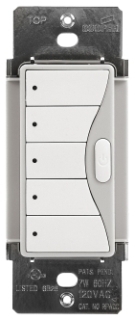

I've added probably 15-18 'smart' devices. All the 'in the wall' switches are homeseer zwave stuff, -100 and -200 stuff. Then a few plug in modules mostly Aeon.
Controlled with a homeseer controller. Plus 3 Cooper 5button scene controllers.
Kinda grows on ya.

z-wave and zigbee are also kind of outdated and unless your already using one that is not the best way to go.
Kinda grows on ya.
I would definitely disagree with Z-wave being outdated! Who wants a home automation setup that relies on your wifi or internet being up?
Z-wave is the way to go. It's an open standard so you have a number of manufacturers making products and competing for your money. Z-wave is a 'mesh' network Each hardwired device acts as a relay/repeater, so the more devices you have, the better your network works.
With HomeSeer and some of the more advanced switches, the switch itself can be used to control other Z-wave devices. For example, the HomeSeer software can detect 'multitaps' of a light switch. If you press the on switch twice or 3 times in a row, the software can detect that and run 'events' like turning on other lights, devices, etc. Some of the dimmer switches even have small colored led lights running down the side which can not only show you how much the light is dimmed, they can also be used for other things like displaying a red light if the front door is unlocked. So instead of having to look at some app on your phone when you come into your house from the garage, all you would have to do is look at one of your light switches and if for example it is showing a blinking blue led, that would mean the garage lights are still on. Then you could program that light switch if you press off 3 times, it will turn off all the lights in the garage. Really a lot what you can do with Homeseer and Z-wave
If your thinking about getting into Home Automation, you need to look at the big picture and see what is available before you start spending your money
