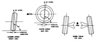

so if you had a pair of three foot long levels with the laser light pointer in one end, would it work to clamp/strap each level to the side of the front tire at about the spindle centerline, with the level bubble centered. Use a tape measure to reference on the tire treads to find the "base" setting. Then project the laser lights forward to say the backside of the garage door, use trig to measure from the garage door to a plumb bob line from the spindle centerline to the floor. The laser spots on the door would also reference the camber base setting.
Would that work to fine tune the toe in/out. Could it also reference the camber setting if you had to adjust the camber up or down slightly?

I don’t like referencing off of the tire bulge. It’s probably fine, but I want to reference something solid. Make or get a spacer (x4) to reference your levels off of the wheel rim.
Your laser dots on the garage door don’t show camber. With some measuring and math, they can be used to show toe.
For camber, you can measure the angle directly. I bought one of those inexpensive bubble gauge camber tools, it mounts to the wheel hub. A digital angle finder would be nicer, but does the same job for more money.
If you’re going to do your own, here’s pretty much everything you need to know.
Doing my car was complicated somewhat by the shape of the car. It’s a wedge, with no straight line structure to reference, and the front track is narrower than the rear. I set up the strings as a box, referenced off of the wheel hub surface, hubcaps removed. This would be a bit easier to do if (like the referenced article) your car has the same track front and rear and some nice straight parallel rockers or frame rails to reference.
