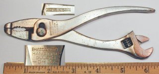

To add on to the above, check this out...even the Diamond "Handy" wrench/pliers combo tools can't get into agreement on what type of throat to use. (Pics from AA).
First, the no. DH16 "Handiman" at 6" long uses a hex throat.
2nd, the no. DH18 "Handiboy" at 8" uses a square throat.
i dont follow. usually i can. but not this time.
they kinda look mighty similar to me

Metaldad- focus on the adjustable wrench portion of the tools. With the wrench all the way open, envision a nut in the opening. There has been much talk of throat shape in this thread, which undoubtedly could be confusing as I tend to ramble on.
You will see on the Handiman that with the angles of the opening, it would conform (somewhat, not exactly) to a hex nut.
On the Handiboy, you will see there are no angles in the opening, both jaws are flat all the way down. The surface the dynamic jaw slides on is perpendicular to the jaw surfaces, effectively making a mostly square opening. (On these square throat wrenches, there is always a small radius where the static jaw transitions to the sliding surface, most likely to avoid stress risers and cracks in the wrench). This style of opening would lend itself to both square and hex nuts.
The difference between the 2 throat styles is mostly inconsequential, I doubt there is a practical advantage to either. However it makes it easier to identify and classify wrenches, and is basically why I'm writing this novel.

Here you go Dave. I cleaned it up a bit so the lettering would hopefully show up better. I don't know why, but this looks a bit Utica "esque" to me. What do you think?
Definitely a Utica, imo. Here is a Utica 10" I found on ebay with the same font on the side that says FORGED ALLOY STEEL USA:
https://m.ebay.com/itm/Utica-Tools-...250000?hash=item3d5eaab1d0:g:MekAAOSwjyhaRu8G
I don't really know much about Utica wrenches, I only own 2...a Utica 10" and a Master Mechanic 8". Both of mine are Triangle Tool production, I would guess yours is older but how old, I have no idea.
Where the jaw slides in the wrench on your Mac...is the hole round, or are the upper corners squared off?
RubiconJK
May 15, 2016
1,382
"I'm bad, I'm Nationwide"
The hole in the Mac is round which may be a fly in the ointment of our Utica theory. Here are some pics. I included some pics of my 6" Utica adjustable which shows that the slide hole differences although the "Forged Alloy Steel USA" text sure seems like a match.
davethorik
Sep 14, 2013
4,992
Norka, Ohio
No fly in the ointment at all, actually!
My theory is the squared off slide was added to Utica wrenches under Triangle Tool ownership. If my assumption that your Mac being pre-Triangle Utica is correct, and your Utica is obvious Triangle production w/ squared slide, that corroborates my theory so far...
Edit: if you meant the font matches on your Mac and Utica, agree to disagree...theyre similar, but look at the top part of the R, for example. Your Mac matches the ebay Utica I posted earlier, which is also pre-Triangle, and has round slide.
I'm sure eventually I will find a real fly in the ointment, like a Triangle wrench with round slide...but for now, I think this holds.
RubiconJK
May 15, 2016
1,382
I see what you mean. I say we declare victory and mystery solved!! Have a great weekend.
